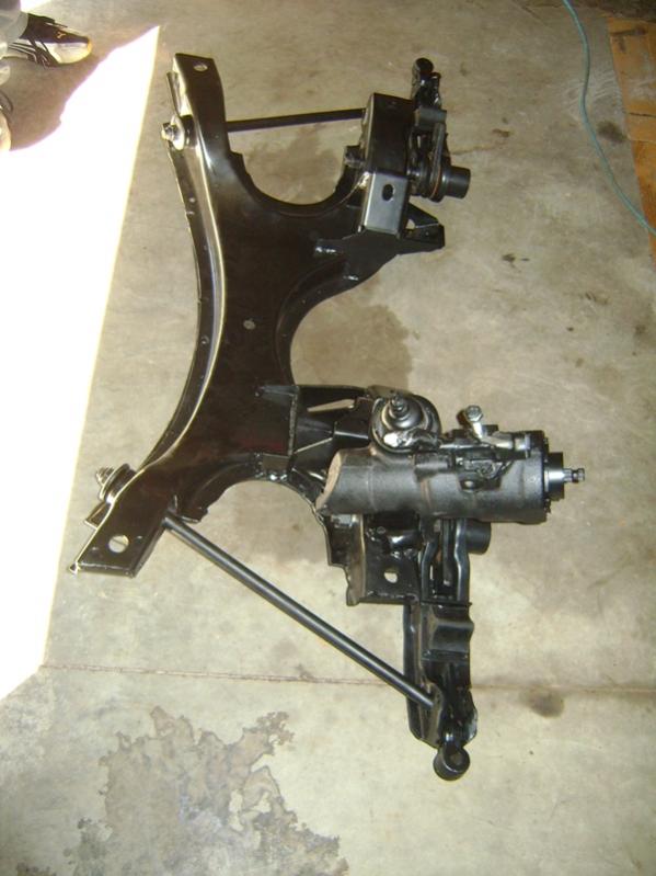

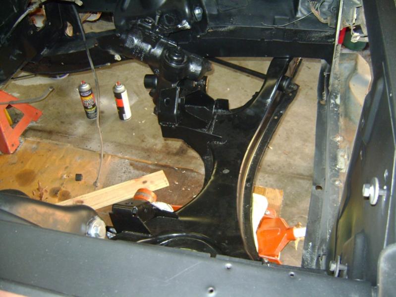

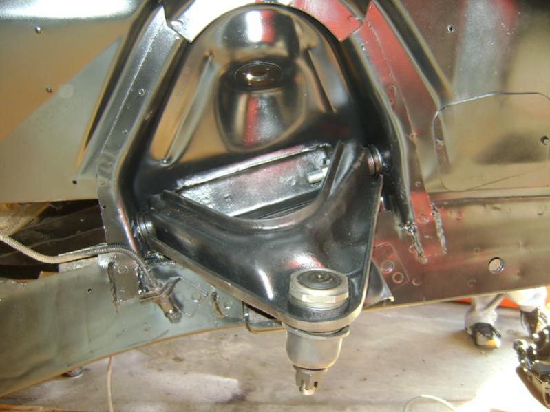

I actually made some progress today in putting things BACK TOGETHER on my 66 Charger. Life and work have just been hectic recently, so it felt good to get something accomplished.
I put a coat of "Underhood Black" in the engine bay, installed the A-Arms and got most of the K-member reassembled today. Before I put the K-member back in place though, I am going to run new brake lines and install the new master cylinder for my disc brake conversion.
Anyway, here are a few photos!

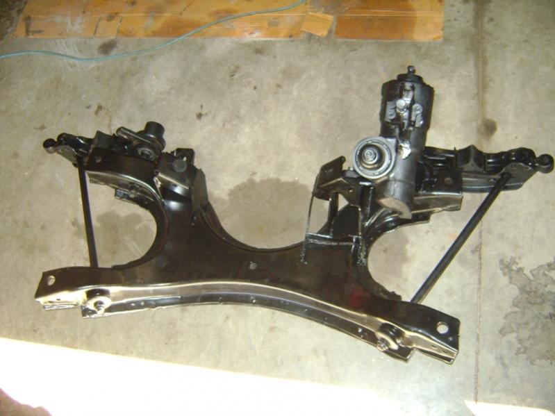

Got the K-member installed today!
Now I need to take apart the front drum brake assemblies to salvage the bolts that attach the lower ball joints to the steering knuckle. Anyone know if these are offered new somewhere? My disc brake kit (turns out to be made by MBM) does not have these.
