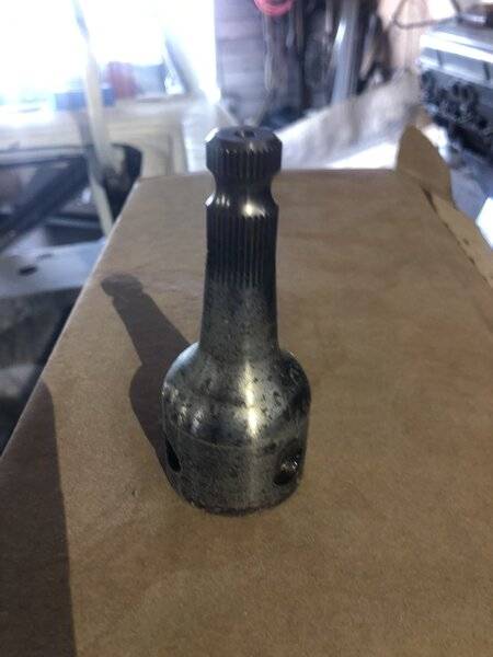

Is the power steering box in the car?
If they used an adapter on the steering shaft to lengthen it to use a manual box then all you need to do is take is off. It looks like this. If that is the case you won’t have to change your column.
