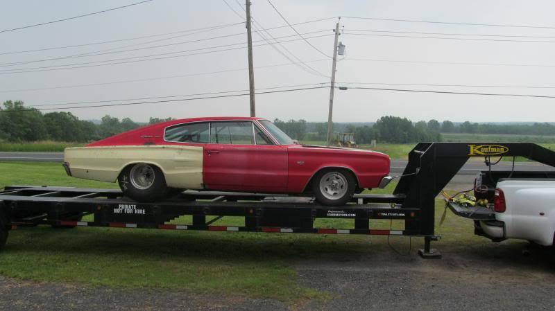

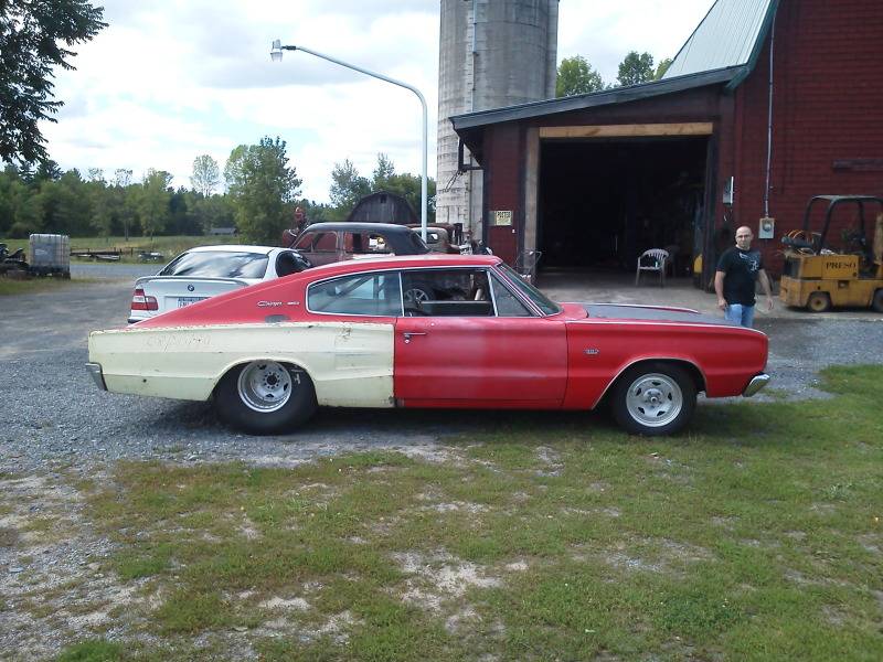

So I picked this up last fall. I looked to see if there were any threads about the car here from the previous owner but I couldn't find any....so heres a few pics.

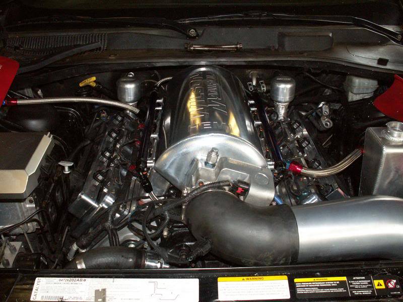

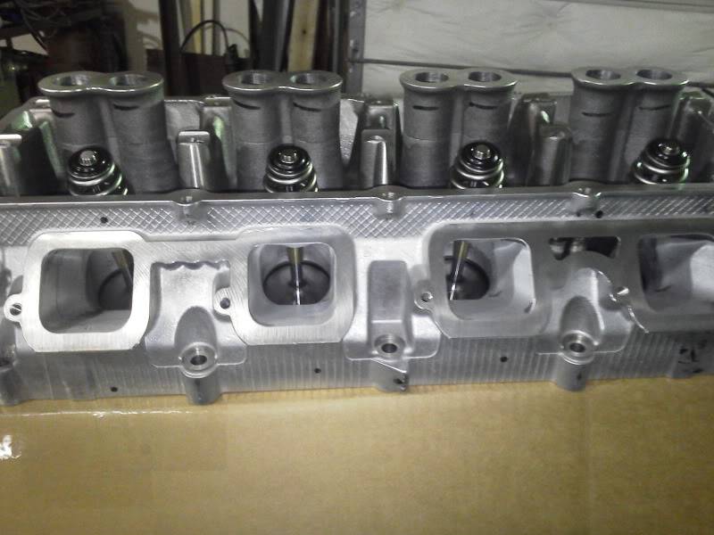

426 shortblock
Apache cylinder heads

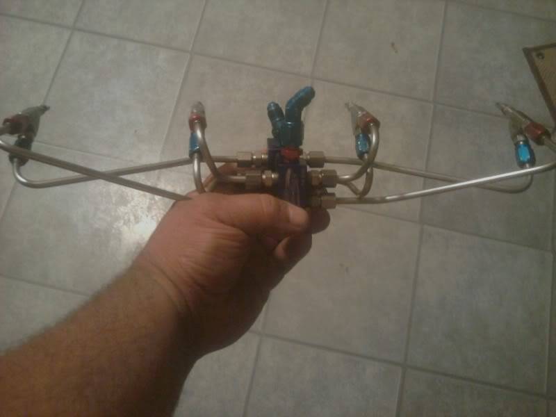

and just cause 640 hp isn't enough.......
A Wilson Pro FLow direct port for a 300 shot.
the rest consists of TTi mounts and headers, built 727,dana 60 with 4.30 gears, Wilwood brakes on all 4 corners and a bunch of other goodies. Will post more as it progresses.
Just curious, how much does that Wilson manifold cost?
I like that Charger ALOT!!!!!
They were $5k each when new. They made 6. I didn't get it new or pay nearly that much. The entire intake other than the top is CNC aluminum.
I like the manifold, but they priced themselves out of the market.
Ever see what most custom sheetmetal intakes cost?
Yeah, they are pricey.

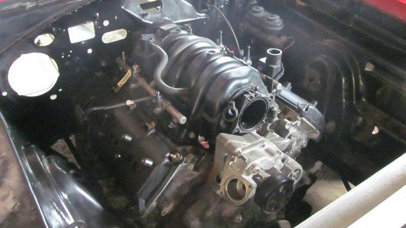

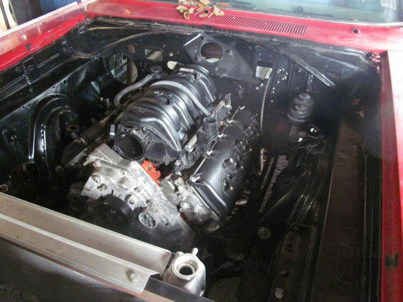

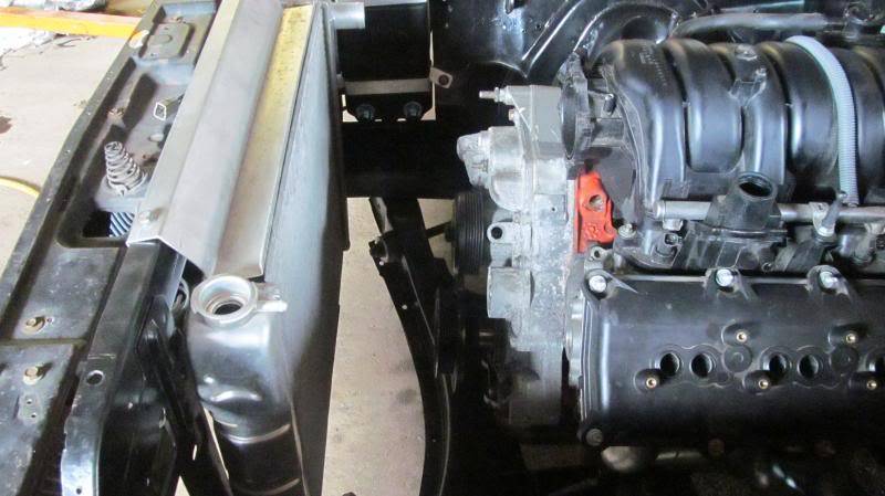

Bit of an update.....got to drop the motor and trans in for the first time. I have heard in the past of people having issues with the TTI stuff but man it fit perfect first shot. Headers clear nice, motor mounts were good.....overall I am pretty impressed. Hopefully the rest of it goes this smooth. Once I get moved I will mock up the rest and start doing body work.
Hell of a stance with the motor in it.
Yeah, it's mostly A body guys that complaing about fitment issues. Keep posting pics with your progress, looking good!!

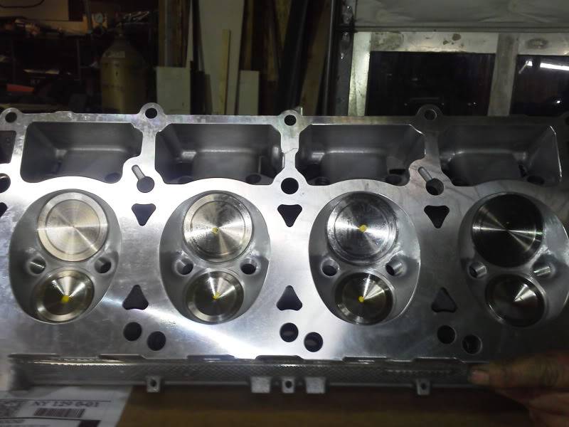

ok so back on this. I wound up putting the car on the back burner for the last 2 years. The 426 and Apaches wound up back in my 300C. I built a pretty ridiculous aluminum 449 for it instead. The shortblock is finally done and will be getting picked up at Billy Briggs Racing Engines this week. The block is 3/4 filled,15:1 compression, billet 6 bolt mains with 1/2" studs, K1 rotator and Diamond pistons. Cam is 265/273 duration @ .050 and went to an aftermarket Thitek head with 2.25 intake and 1.7 exhaust valves, the Wilson intake is still going on top with a 100mm throttle body and have added a dry sump to the bottom with motor plates front and back. Looking for 800-850 at the crank and 1000-1100 on dope. First order of business is getting the cage certified, motor plates set up and plumbing run so I can blow it apart for the body shop;
