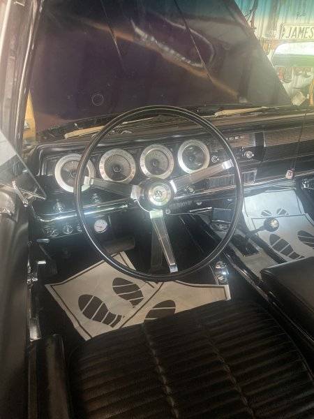

My 66 Charger will turn more one way than the other and it can’t be adjusted anymore without fear of tierod coming out. Anyone have this happen? What am I missing? Nothing is loose all joints are good. Is something on backwards? I haven’t messed with anything besides trying to align it more so that it’s equal. Appreciate all and any help Thanks
I want to take it in to get aligned with the machine but don’t want them to tell me what’s wrong and wanna charge me a rediculous amount. The nearest place is at least a 60 mile round trip
Aftermarket steering wheel? These can be installed straight up without sector shaft being centered.
Nope she’s original
Did you convert it? Mine does the same after I converted to manual steering. Must have gotten the the pitman arm out a 1/4, but at the strip most of my turns are one way so I left it ever since :lol:
I didn’t convert it to manual its power. I did get a modern feel gear box but it did it when I got the vehicle. She turns left more than right.
