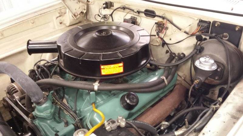

I have a 361 in my 64 Fury. I put a factory 4 bbl intake and carter afb from a 383 Chrysler on it a few years ago, while trying to keep it stock looking. The factory 2 bbl air cleaner will work with an afb. But a later avs or an Edelbrock has a larger air horn.

Budget is not the concern. I've put way more money into it than I can get back...its my baby. While I understand the benefit, headers will never happen, and the hood insulation touches the air cleaner on closing now, I don't believe there's another inch there. The look of "big bad dad's" engine compartment, is what I want to maintain. I've heard that the Thermo Quads were good and were an original for big blocks of that year, but Edelbrock's or Holley's have evolved and fuel economy is better, choke's is vastly improved. I'm aware that the air horn is larger on these, I have another air cleaner base that I could sacrifice ( why could't they have kept that the same??). Thank you all for your experience and advise.
