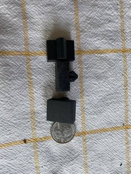

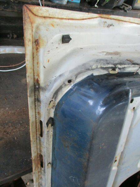

Hi Folks, In the bumper kit I bought, I got these three bumpers that I do not know where they go. Can someone help identify them, please? Thanks in advance, B.
Thank you 440, you may be correct, but I do not see any place along the trunk lid or along the body where the trunk closes to put them. Perhaps they have another function?

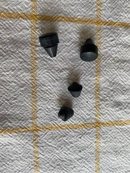

Got these as well that I have questions about where they go. Perhaps the smaller one on the backside of the lower part of the trunk lid?

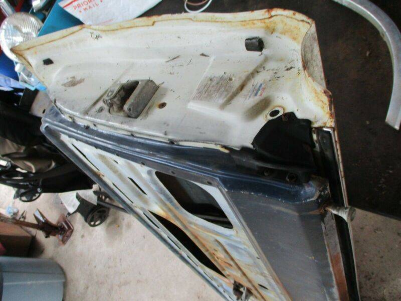

Look in the rear portion of each door for slots. I believe they are door bumpers. first ones you posted. second set glove box door and possibly ashtray. Maybe
I will have a look see. You guys are GREAT!!! Thank you. B.
This is what the door bumpers should look like. So I am wrong on that first set posted. If you look at the kit it lists hood side bumpers 2 times. However there are only the 4 slots for the half quarter round ones and 2 holes in the rear cowl for the round style bumpers. Where does the second set go... Same ones you asked about first.

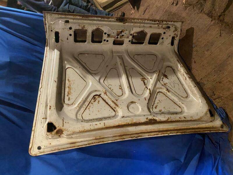

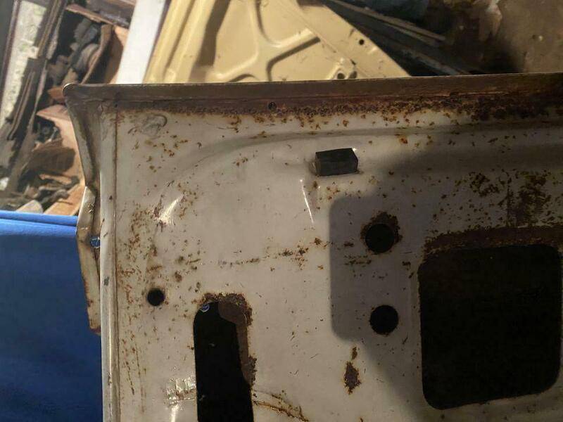

Got it... The 2 flat ones go into the trunk lid. Here check out this picture.
View attachment 1005112View attachment 1005113
HOT DOG!!!!!! Found the slots!! THANK YOU!! BEST, Brian

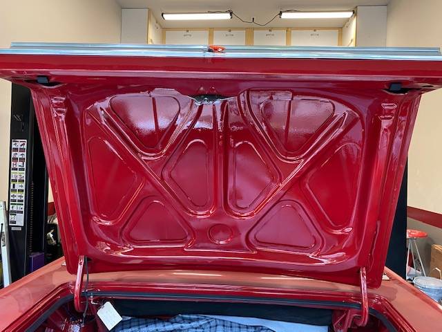

Beep, Here is where they go when looking at the back of the trunk. I really appreciate the coaching. B.
