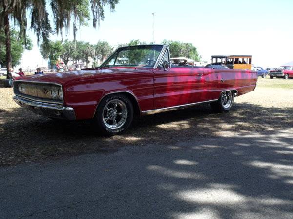

Front wheel and tire combo: 1966 Coronet with Torque Thrust 15'' x 7'', 3.75'' back space & 225/70R15 tires. Anyone running this set up? or know if there will be a clearance issue? Thanks in advance. Tyler

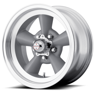

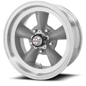

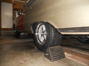

I ended up going with the Torq Thrust VN105D style instead (mainly because I found a "like new" set on craigslist last year). They are a 15'' x 6'' with 3.66'' back space mounted with a 225/70R15 tire. They fit great with no clearance issues. Good luck!

Should work fine on the fronts, its the rear wheel well on the 66-67 that gets interesting..
Should be no issues with that combo. Rear is tricky like joe said. I’ve managed to fit a 275/60/15 it’s not easy but I can help if you want to go that route

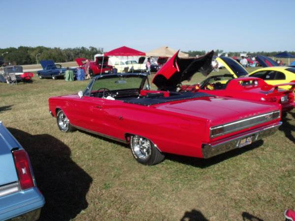

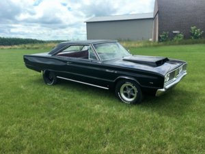

15 X 7's on front with either a 4" or 3 3/4 bs ( been a while and I cant remember) LOL

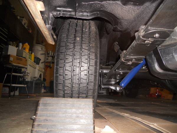

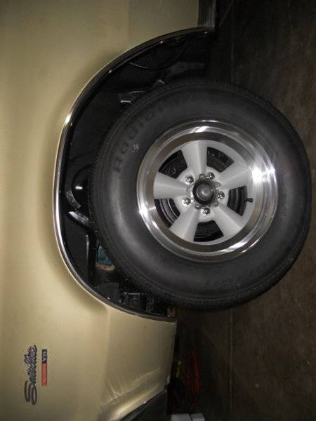

Thanks for the reply's. Got the wheels on. Needs to come down in the front a couple inches. Lots of room everywhere. Missed the whole Dodge part. Working on a Plymouth. 225/70 15 BFGs with 15 x 7 Americans.
