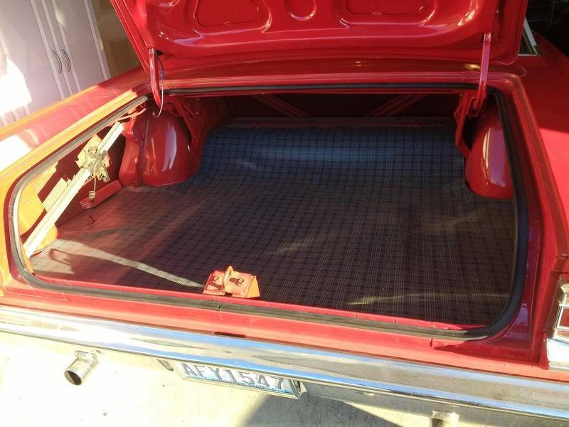

Hello everyone does anyone have a photo of how the bumper jack is stored.on a 66 coronet
here is a 66 Coronet bumper jack setup, the jack is on the left and everything else is stored with the spare tire in the floor under the board and mat

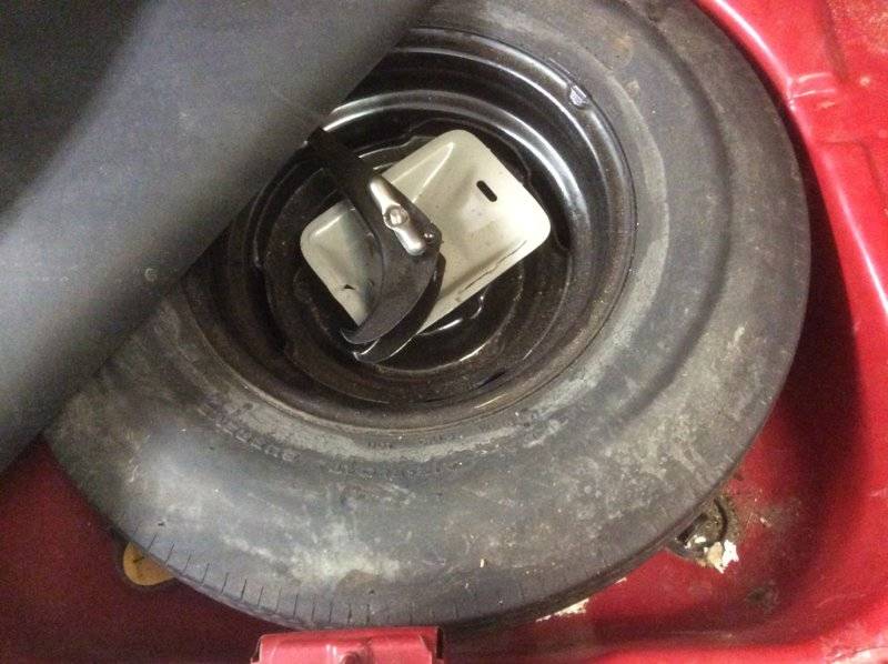

The board is lifted so you can see the rest of the jack parts, the black recessed cup fit in the hole in the center of the board and then the wingnut goes on. So the wingnut is down below the board, then the mat goes on top

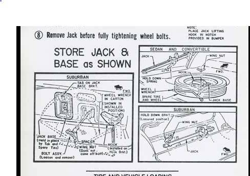

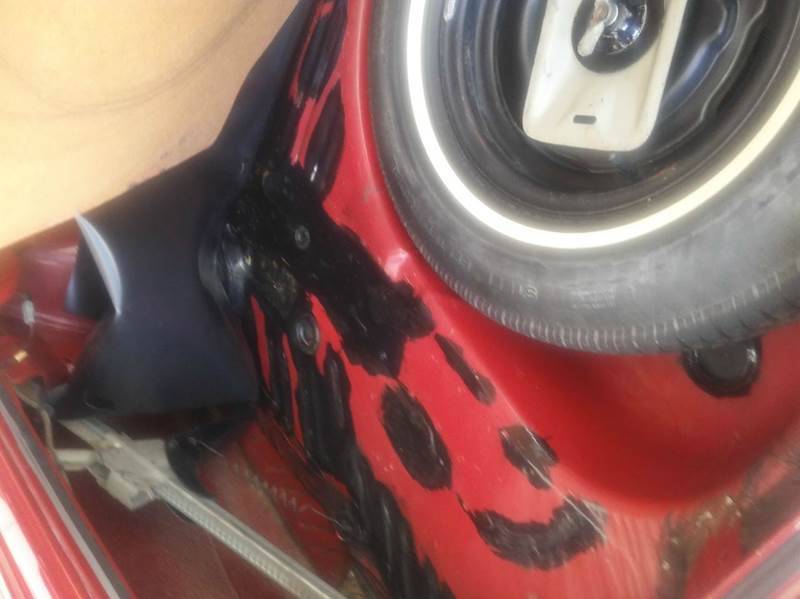

Moes not in competition with you. Tire should be flipped so outside is down, jack base plate next, bottom facing up then hook large wingnut, hard board cover, cup and then small wingnut.

thank you great picture
