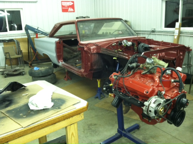

Belve.jpgThat is the way we are going
That's a nice looking engine.
The car looks great too.
