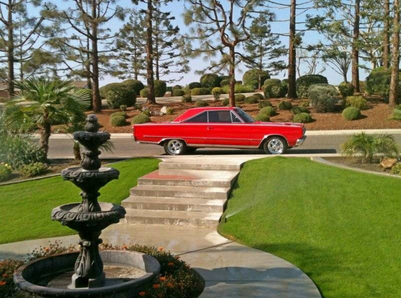

Its on Ebay, older guy says he has had it for 9 years.
Its a 273 Commando, matching to the car he says.
California car its whole life.
Here are the specs as he laid it out.
My main concern is the rusty areas.
He is asking $9500

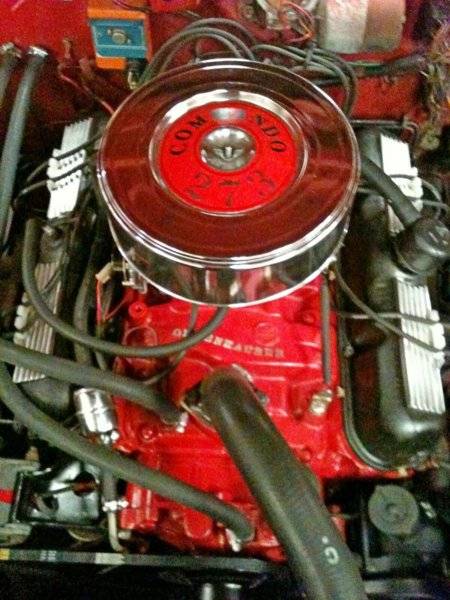

  • Original 273 cubic inch small block LA motor.

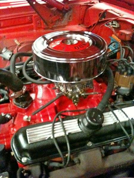

  • New Edelbrock performer series 4 barrel carburetor.
  • Offenhauser aluminum intake manifold.
  • Factory 273 Commando valve covers and air cleaner.

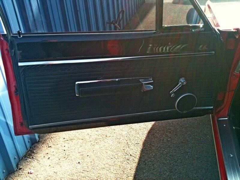

Has new OEM front seat upholstery and pads installed.
Have new rear upholstery, did not install yet, trying to locate rear seat pads. New door armrest pads.
Dash is all original with factory AM radio, I installed an under dash mount for aftermarket Sony radio/CD player. Has 4 speakers, two under package tray and one in each door. Headliner and visors are new, glass is tinted and in excellent condition.
Manual door window regulators work smoothly. Previous owner removed all lettering and emblems and had car painted, I have everything that was removed.

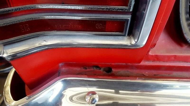

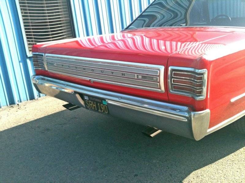

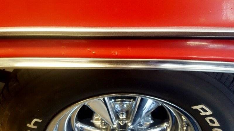

Paint has a few small blisters under the paint above both rear wheel wells, has a small rust spot under left tail light in the bumper apron and has minor rust perforation in the driver floor foot well. These are typical for southern California coast vehicles and can easily be repaired.

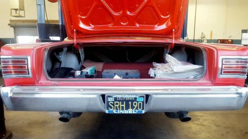

Only body damage I found on car is a minor fender repair at the left tail light, can be seen from inside the trunk. Has dealer installed body side moldings that need to be removed when car is repainted, in my opinion.

Just wanted some thoughts on the asking price and other than rust in the frame rails and cowl, what else to look for? Seems like it is priced right, but I don't know these older B bodies well

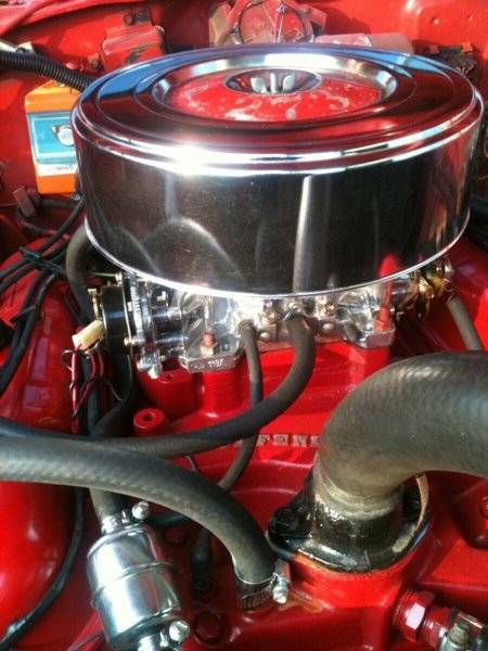

B body cars did not come with 4 barrel commando 273 motors.
It would have been a 2 bbl
the side molding near the bottom has obviously been added
the rust spot pictured in back of the rear bumper is in an area that is severely rust prone on these cars.
check that area carefully as well as the rear wheel arches, and the front frame horns and trans cross member
...and the area under the chrome trim where the roof C pillar meets the quarter panel as well as the underside of the dutchman panel between the deck lid and the rear window

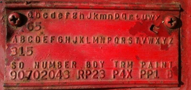

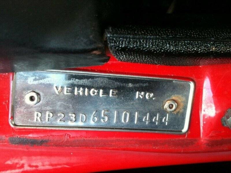

even the data tag has rust/rot under it..

also,YY1 pointed out some areas that you should Deffo look at from Inside the trunk if possible.
lotta people bitd just bondoed those rear window areas....
He stated in his add he put a new 4bbl carb on it. Not sure if he has the original carb or not. Only the super commandos had the factory 4bbl correct?
