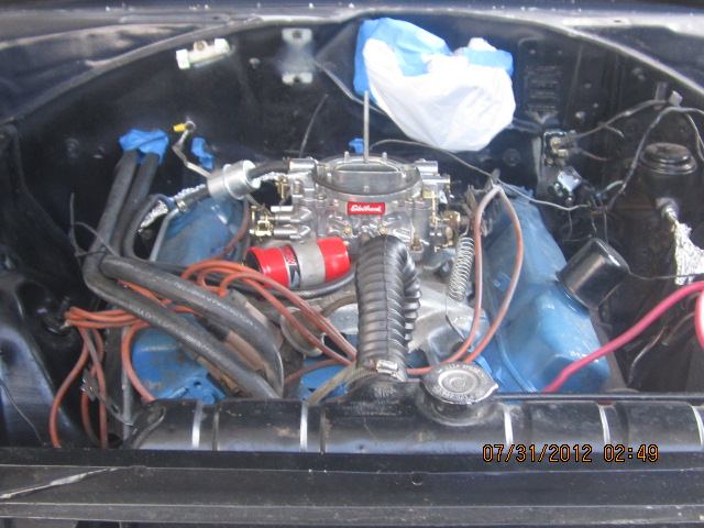

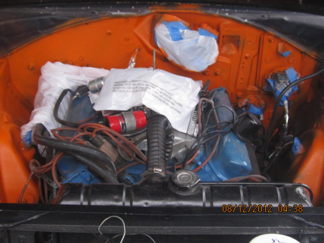

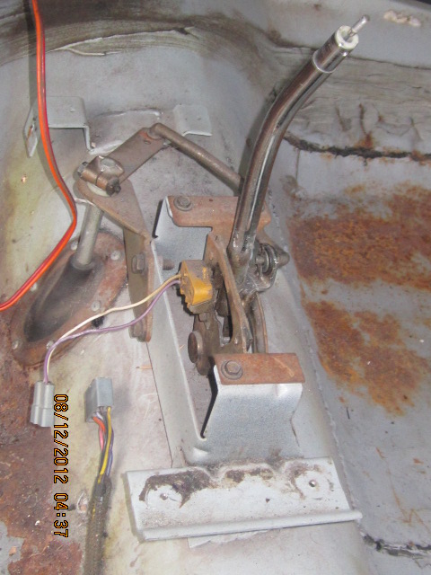

Couple of Photos showing progress

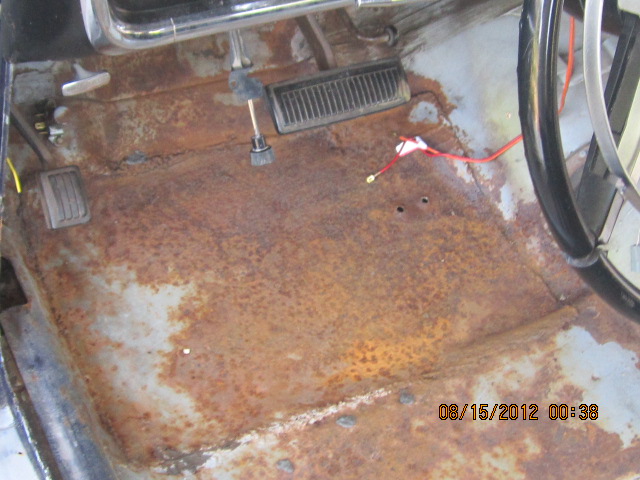

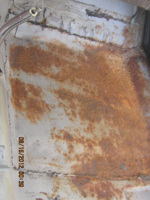

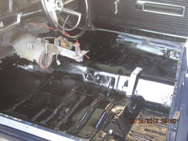

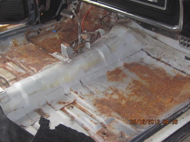

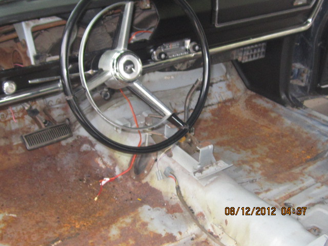

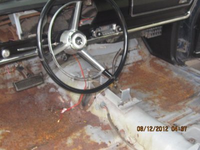

Floor Pan Clean Up
Pans overall in good shape. Panels have been welded in place sometime in the past a little rust and a few pin holes but oveall in good shape and solid.
Wire Brushed, a little JB weld in the pin holds and painted with POR 15.
