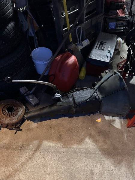

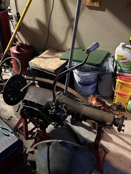

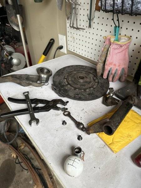

Looking for some help in putting together a 4 speed swap in my 67 coronet with a 440. I currently have these parts and I’d like to know where and what I should do.
I have a 63 T10 (up for sale)
A 65 A833 (trans and shifter only)
A neutral 10.5 flywheel
A torque shaft from a 63 with ball pivots and clutch fork.
And a B&T driveshaft
Is it worth making the 65 833 work in my 67? The speedo cable is the only real thing I’m running into an issue with. Can I use a 65 speedo cable in my 67? Should I sell and buy another 833? Does anyone make a master and slave setup for these cars? Help!

It’s to my knowledge that all that I need as of this moment is a bell housing and a speedo cable that’s compatible with this tailshaft. I do have the right driveshaft but I do not have the correct crossmember
