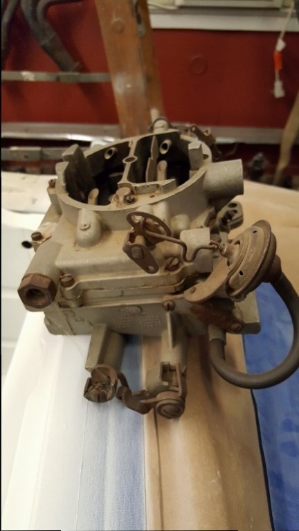

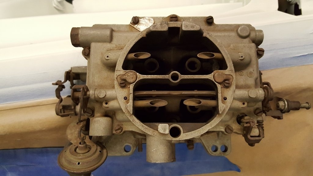

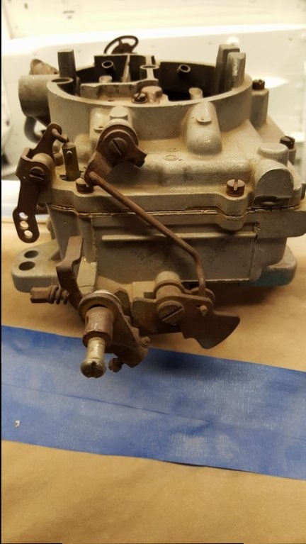

What parts are you looking for?
This is a 4131s k5 AFB '64-'67
