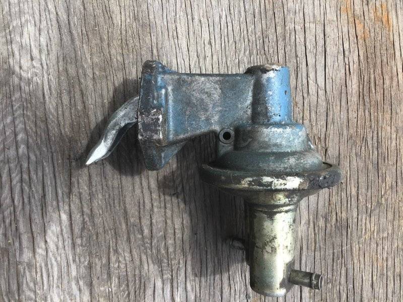

I'm trying to install a new fuel pump onto a 1967 440 and the pump will not go all of the way into the engine. It seems the pump lever or arm is too straight or too long putting the pump on a steep angle when the arm is under the pushrod and, the bolt holes don't line up. The pushrod inside the engine is all of the way up. The parts store confirmed that the part number is correct. Is there more than one pump for a 440? Here's a photo of the new pump and lever.

Otherwise it looks right to me
Wrong pump, it's for a slant 6. Mislabeled or in wrong box.

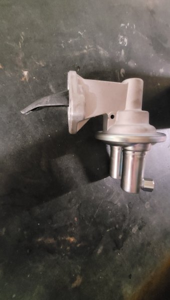

Look at photo of a BB pump see where the arm is compared to post #1? You are correct it is too long and at the wrong angle.
Keep your daughters away from the small block pump I guess..
This is the only part numbers on the pump. The parts store confirmed that this number and the numbers on the box are correct but, their website picture shows a different pump, the pump I need. I'm taking this pump back today. I'll post what happens later.

The slant 6 amd BB pump look like the same casting with a different arm.

I went back today to the parts store to return the first pump and now have the correct one. And this time I opened the box and looked at the pump before leaving the store. All looks good. I now need to install it.
