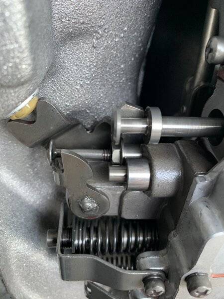

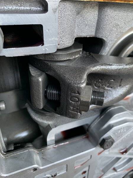

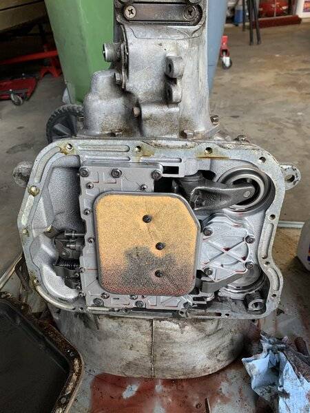

Well, zero varnish in there. So far. Looks really good. Still will need a rebuild, man....valve body looks clean.

Doin a full Tranny tear-down 1st time solo, ya got more v-body "balls" than me ! How doya know what ya don't kno ? ..Messin with that v-body grooved-up "brain" gives me a headache just lookin at it !

Its pretty logical, and straight forward. I'm going to take my time.
