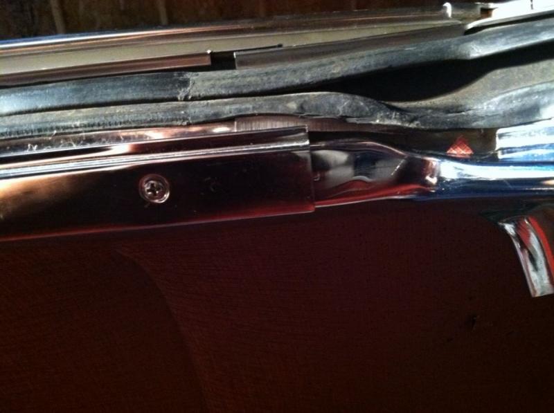

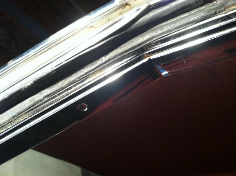

67 2dr hardtop. Trying to get this beater back together after 8 long years.
Interior chrome that goes above the door. does it tuck behind the roof rail weatherstrip chrome?
here is my attempt

Yes, the chrome trim should tuck under the weatherstrip channel, meaning you have to put the chrome trim on and then the weatherstrip channel.
yep, I used some adhesive on the bends and corners, looking good!
thanks guys. i got it.
