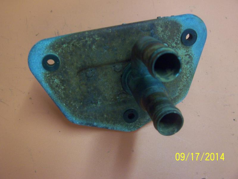

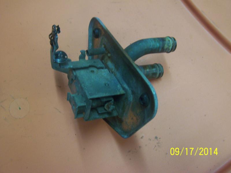

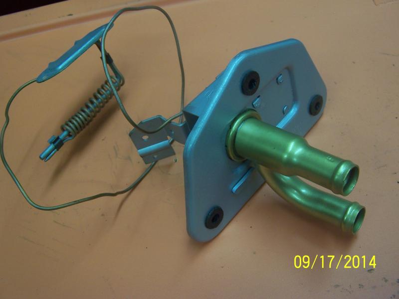

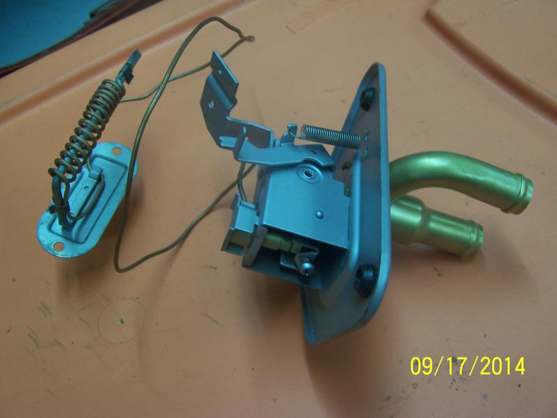

100_6560.jpgIf you go with an aftermarket valve mounted in the engine compartment, you will need a longer cable. The existing cable will not be long enough. Plus, you will have to deal with the large hole in the firewall where your existing valve is mounted. If you want to stay with the stock valve, I can send you the one in the above pictures that I had rebuilt. It cost me $109.00 to get it back from California. My car will not be going back together until next spring and I have a couple more of these valves that I can have rebuilt.
I know it is spendy but it solves your problem. Another problem you may run into is the valve that is located on the heater core inside the heater box itself. Mine was stuck and needed to be replaced. That was another $82.00. Maybe yours is ok but if is hard to operate, the vacuum actuator will not be able to move it.

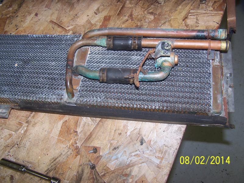

Here is a picture of the heater core valve.
I haven't had the heater box out, so I'm not familiar with this picture. If that's a vacuum operated valve then that's the one I thought I was trying to shut off.
Do you know why there are two valves.
I knew this was not going to be easy!
