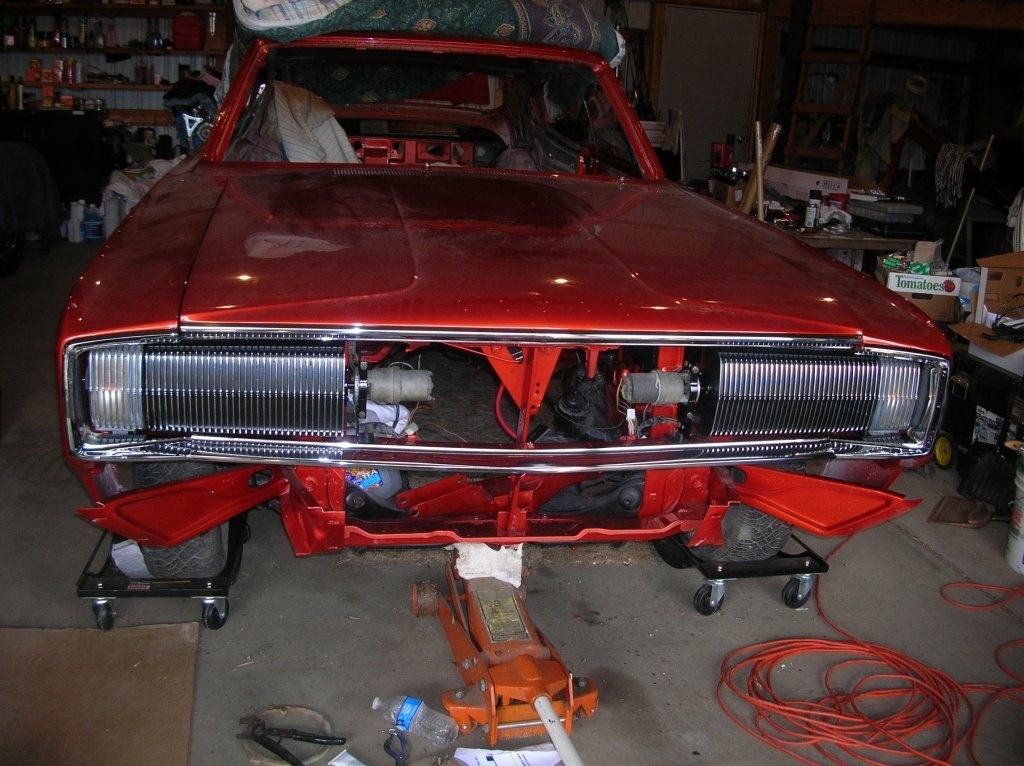

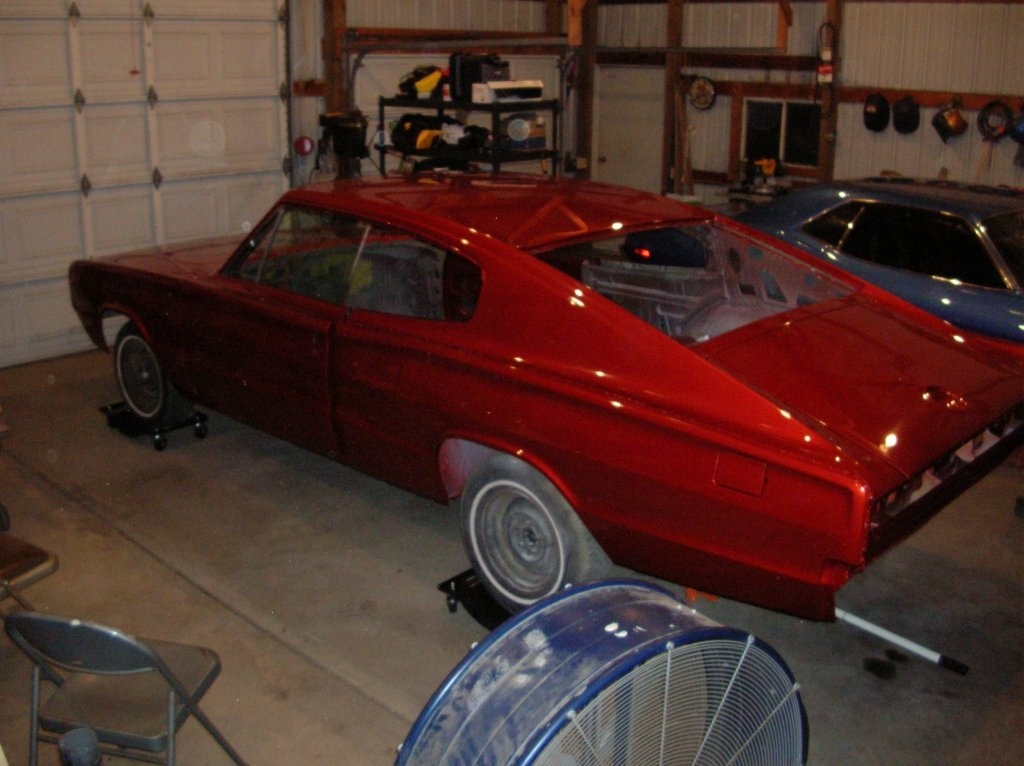

Thank you both....I now realize I am missing the bracket the EL mounts to which mounts to the underside of the dash. I will look through my parts boxes once again to see if I can locate it...and if not I believe I can make one. Attaching a couple pictures

I have the correct OE bracket for the powerpack...
Mark
Mark....I found the bracket and have it installed along with the EL and most importantly everything works.....
