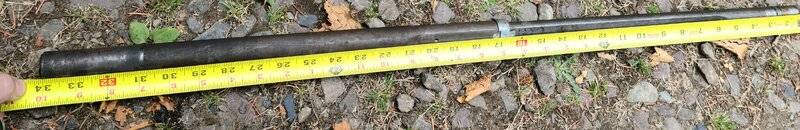

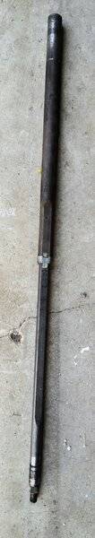

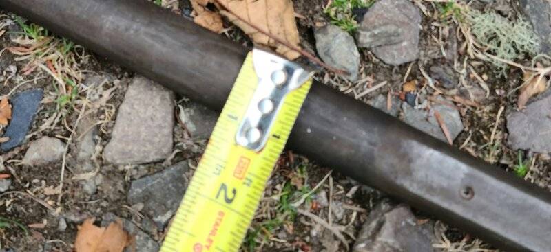

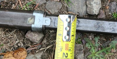

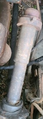

Hi, everyone.
As seen in the photo, the internal shsft of the column snapped at the steering box.
How do I go about getting just this part?
20210829_101632.jpg 20210830_141106.jpg 20210830_141126.jpg 20210830_141134.jpg 20210830_140843.jpg
It is a power steering car with a floor shifter and dash key.
Is the only thing that affects the shaft length and setup the power steering?

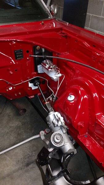

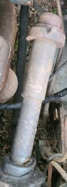

Does anybody know how the end of the shaft installs onto the gearbox? Mine is frozen and I am unsure if its a spline or a slip on.
The coupler slides over the shaft on the gear box and a roll pin locks it in
you have to drive out the roll pin
The notch on the end of the coupler aligns with the master link on the gear box
It is splined
Here is the best picture I can find
You can see the hole where the roll pin goes on the end of the coupler
