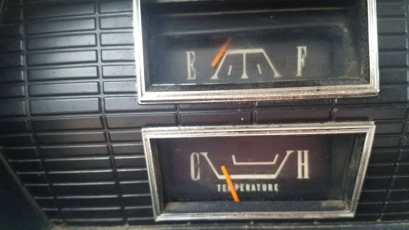

The car is a 67. I ran the car for 20 minutes and the temp gauge did register (see photo).
First, thank all of you for the help. I will try to answer everyone's questions. The car is a 67. I ran the car for 20 minutes and the temp gauge did register (see photo). I replaced the whole sending unit not just the float. The grounding strap was reconnected to the new sending unit. I am not sure if I still have the original sending unit. It may still be in my garage.

Based on the temp gauge working you ‘should’ have voltage at the gauge.
