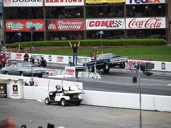

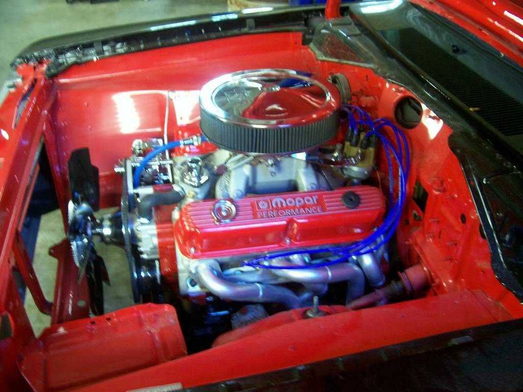

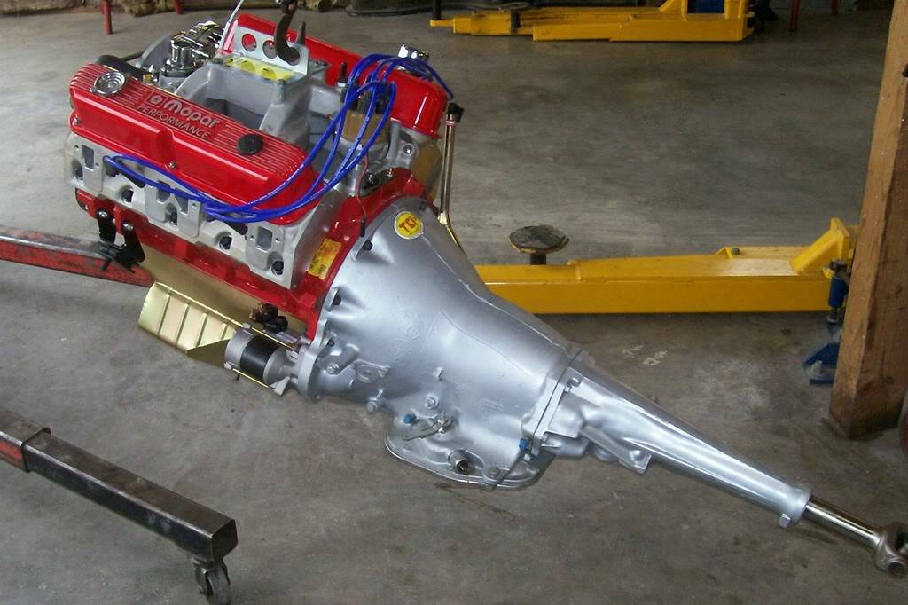

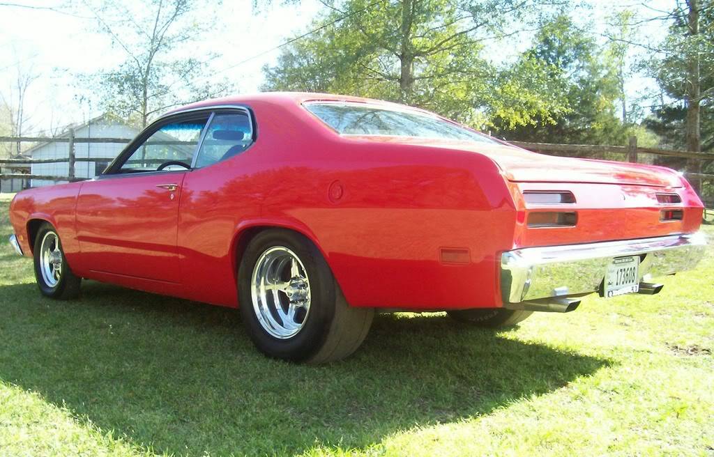

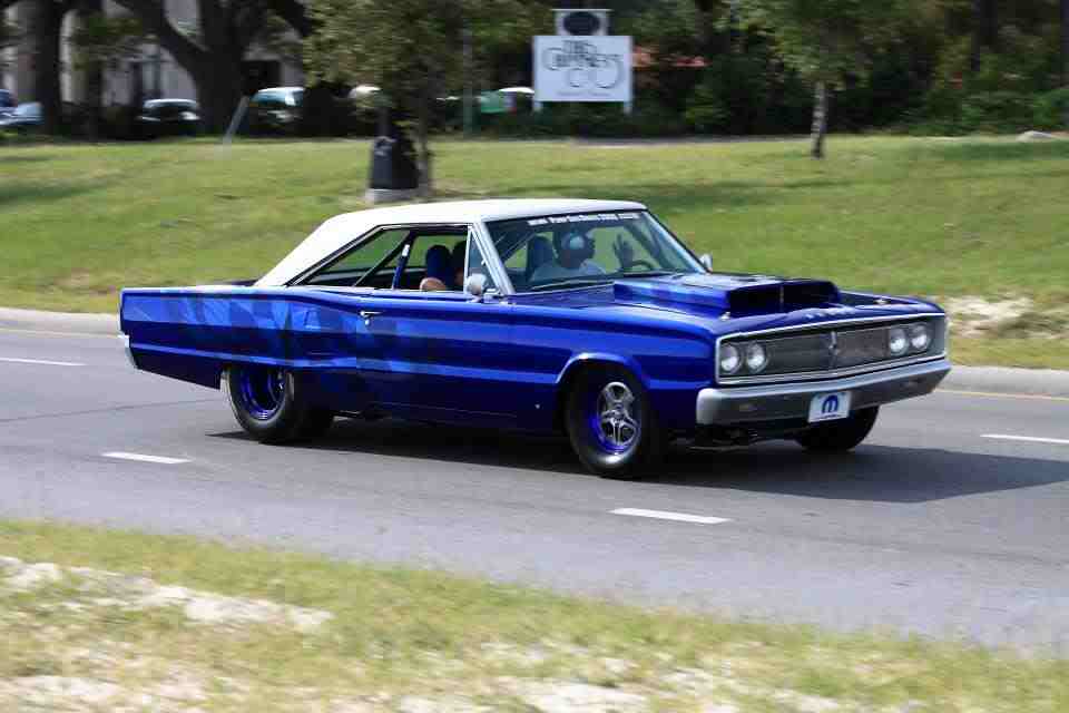

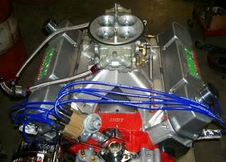

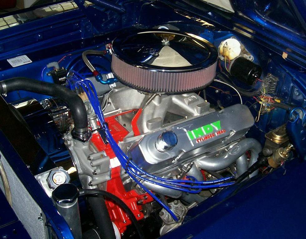

Mine is the Coronet and the Duster is my son's. The Duster was done 5 years ago and the Coronet 4 years ago. Both of these are street/strip cars. Mine is a 501 Indy headed .704 lift roller motor. My son's is a .020 over 360 with Eddy heads, .508 lift hydraulic cam. Both have monoleaf cal trac setups,both have 4.10's, Dana 60 in the Coronet, 8 3/4 in the Duster,both have 727's with transbrakes.Both cars have billet specialties wheels and drag radials. Both have dual exhaust with x-pipes, his 3 inch magnaflows, mine 3 1/2 hooker aerochambers. His best et to date was 11.77 @ 114 mine was 10.22 @ 130. We are gathering parts to install the 501 in the Duster and I am building a KB Aluminum Hemi for the Coronet. Below are a few pics along the way. The Coronet is ever evolving. The Duster is by far a better appearing/show type car and has won Best "A" body numerous times and won 1st Place young guns modified at the Nats this past year. Below are a few pics from along the way.
A few parts of the Hemi puzzle.
Pretty Impressive, I like what I see.I see 10.22 @130 cool.I have the mph in my car but I must have traction problems.10.67 @ 127mph.I will just keep plugging away.

Just beautiful, that's all I can say. Two very impressive cars!
