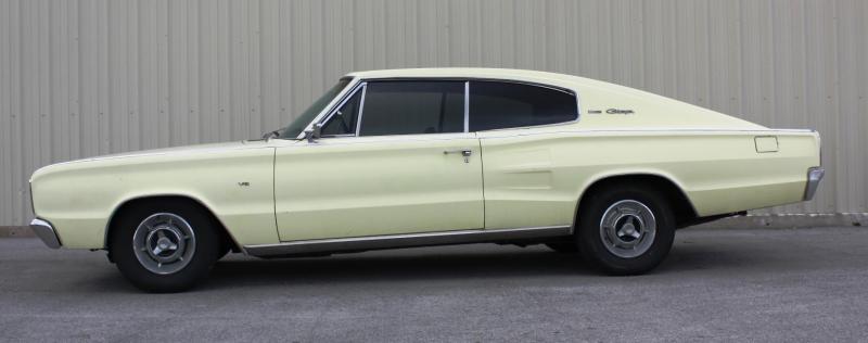

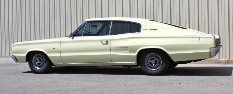

Has anyone got side view pictures of a 66 Coronet fitted with the Hotchkiss uppers, that might show the affect on the wheel position ?
Not a Coronet but a 66 Charger before and after Hotchkis suspension.

the front wheel looks as it sits a little more backwards..... in the second pic
I had a 75 Firebird... bought those UCA from GW the result was ULGY Perhaps nice on the racetrack...but on the street... ?
So what Did I do ? I shimmed the UCAs "back" to lower caster numbers....
