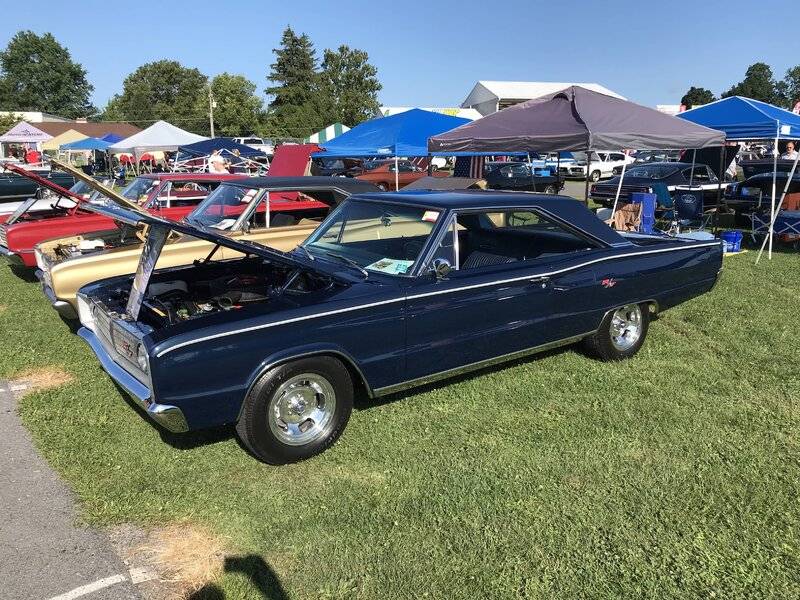

J4 on the narrow sill between the vent window and the end of the rear quarter window, both sides.
The white stripe runs the top body line. It's about a 1/8 wide from the front of the front fender to the end of the rear quarter.

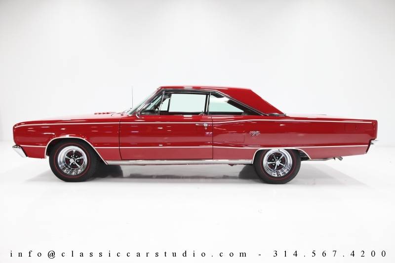

I believe the J4 is the bright molding on the rocker sill between the wheel wells. These were standard on all R/T's, along with wheel well moldings. The R/T does not have the molding Jerry describes at the top of the door. The horizontal stripe is a double line stripe that runs the top body line as Jerry says. I have never seen the lower door wide stripe ( looks like a Fairlane stripe ) shown in the ad on an actual car. Another ad shows not only the stripe at the upper body line, but also another at the lower body line. I have never seen this treatment on an actual car either. Cars that got factory redline tires actually got 5 of them, including the spare. Just as cars that got whitewall tires always got 5 of these. I hope this helps. I own a 1967 R/T.

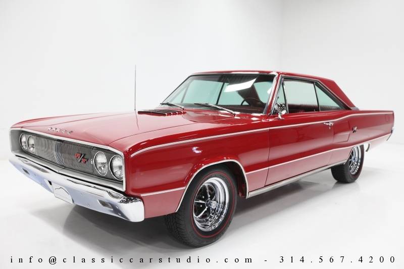

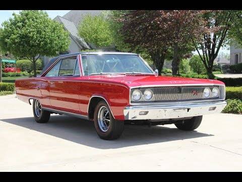

I found this picture with the stripes....does this look correct?

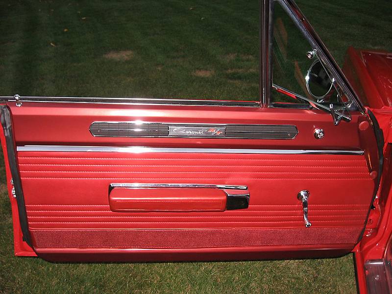

everything on the inner front doors that is not covered by the door panel is red...which part again is supposed to be black? (I assume someone painted the car wrong then)
View attachment 1255214 View attachment 1255215
The top part of the stripe is correct other than being to big. The lower part of the stripe is not supposed to be there.
The door frame picture on this car is red, but if it were black, the door panel would be the only red. Ofcourse the chrome strip at the top of the door panel would be the same.

I have heard and seen more than one picture that shows the car with two stripes....I'm just trying to find out which one is correct, or if they both were

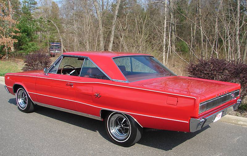

found other pictures of the double stripe...also of just the single top stripe

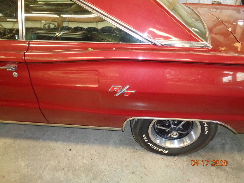

I exactly duplicated the factory stripe when I re-painted my original 67 R/T. It had the top double stripe only.
It doesn't always show up to well in pics since the car is dark red and the stripe is black.
Here’s what the stripe looks like. That double or lower stripe in the media ad never made it to production.
The paint treatment on the door is correct for this interior trim colour. The black upper and lower door paint came on cars with black interior ( obviously ), or white interior. The white interior cars also came with black dash, console, package tray, seat belts, and carpets.

I also forgot that the Dodge got the double stripe on the upper body line while the Belvedere got the single stripe.

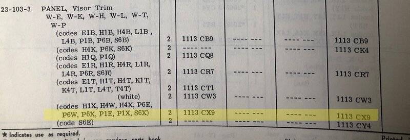

what about the sun visors....my 66 Charger with white interior has white sun visors...they are black in my friends Coronet
What is the colour of your headliner? They would typically match the colour of the headliner.
The headliner of my 66 Charger is black, white was never offered. This car has white sun visors from the factory.
The Coronet in question which this thread is about has a black headliner and black sun visors....the question still remains unanswered, should the sun visors be white with a white interior in the car?
P6W interior in a 23 body style gets the black visors.
It's always best to check with the appropriate factory info as, sometimes, crossing years and models may not be the same.
