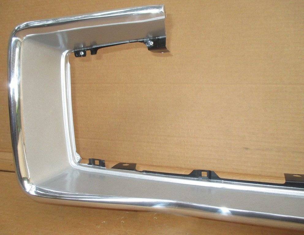

I restore the Surrounds, if you need yours done.

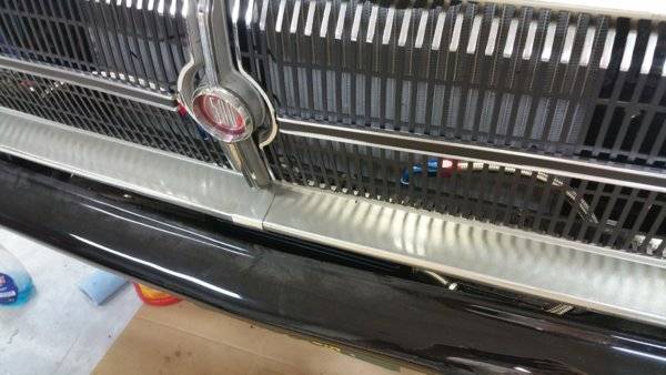

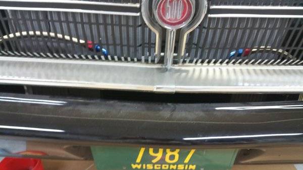

Partsmonsta, when you restore surrounds, what is the coating on the inside? Is it a paint? I’m polishing mine right now but would like to respray whatever coating that is. Can’t find the answer anywhere!
My paint is specially mixed, but you can use DUPLICOLOR WHEEL SILVER (Advanced Auto Parts or order from Jegs/Summit). Spray light coat on first, then another light coat. Three total. Do not spray one thick coat, this paint is designed for light coats built up.
This is exactly what I used to redo mine. It's not perfect but definitely satisfactory.
