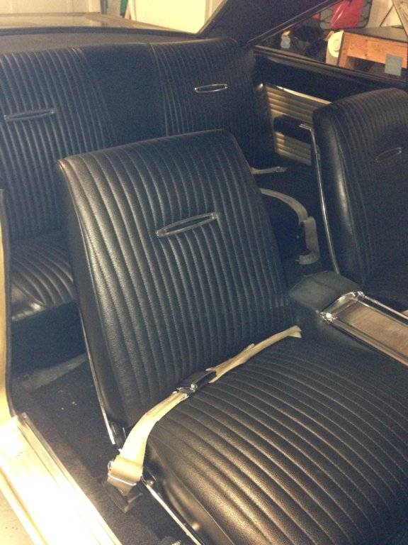

Have a question, how do you install the seat medallions? I have the seat medallions for front and back, but my seats have been recovered and there are no slots for the tabs to go into. Do you just cut the vinyl? I would think it needs to be reinforced so it doesn't tear. Also, what are the measurements for where they go (measurements from the sides, bottom and top of the seat)? Any help or pictures are greatly appreciated! Paul
They appear to push through the vinyl and have a backer. I can take photos of original ones later this week with measurements for you along with pictures of the back of the rear seat where they come through.
Have to remove seat cover backs, push through in front, attach backer plate in back and bend tab over, reinstall seat covers.
So you have to remove the entire seat cover to put them on? Does the backer plate go on between the vinyl and seat foam? Or between the foam on the springs?
Trying to recall, think the backer plates are in between the outer springs so they don't show against the back fabric. Put the front of the cover on and push through the tabs and then pull the back down.
Got the dimensions from an R/T survivor owner. Here are the results. Super pleased!
