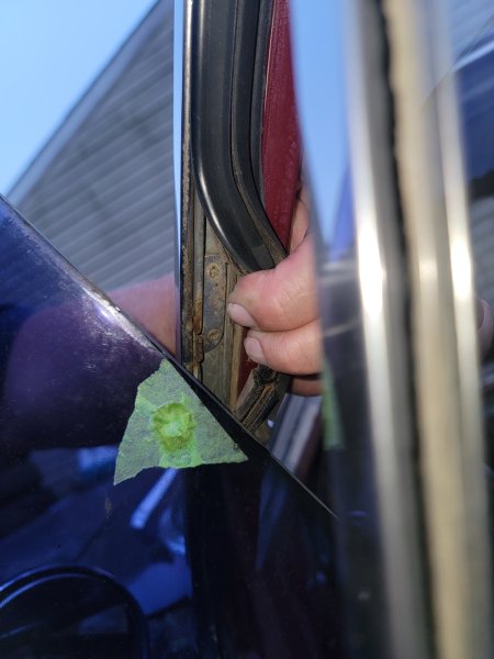

how is this attached?
mine is missing and ive acquired a new frame but would rather just put the pivot arm on my new one if possible
it looks like there are 2 rivet heads close to it under the gasket.
do the rivets hold this arm on?
if i ground the heads off do you think i could remove it without damaging the gasket?
how would i reattach the new one?

this is what i have.can i drill the rivets out from this side and put new ones in with the new pivot from the opposite way they were installed?im thinking the old head will get trapped in there and i wont be able to put a new rivet in at all.
