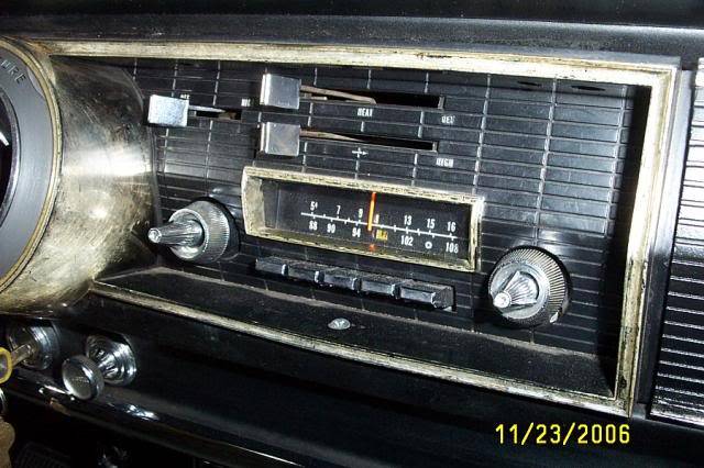

I got factory AM-FM in both 66's here...works fine..note chrome push buttons is original style
