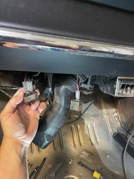

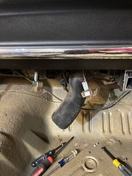

There are 2 flasher relays under the dash by glove box. 1 for 4 ways and 1 for turn signals.
Roger....so, maybe....my emergency relay is bad. The other one works great. I just am putting my head around why I get both tail lights flashing when I use my turn signals.
Ok, so I dropped both flashers down . One is definitely bad. The one on the emergency switch . You need both to work properly to complete the circuit. I’ll get a few replacements
I’ll add a few pics here
5F3F8C0B-4055-455B-BD8A-9701B686EB01.jpeg C07D3AB9-C22D-4F6D-867A-DB54507C47DD.jpeg
Solution, was pretty simple. Get new flashers. Both of mine were crapped out. Having a bad flasher for the emergency will kill the function, and leaving the switch open for the emergency caused all the lights to flash....obviously. Went to NAPPA and scored to great flashers and poof.....fixed.
