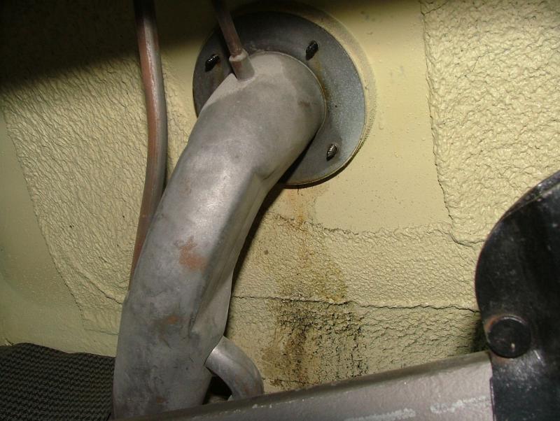

There is a seal the goes in between the filler tube and the inside of he quarter. It's a special seal that has two bumps to fit the notches of the filler tube. It is also tapered. If you are leaking inside the trunk, I'd look into that seal.

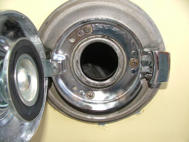

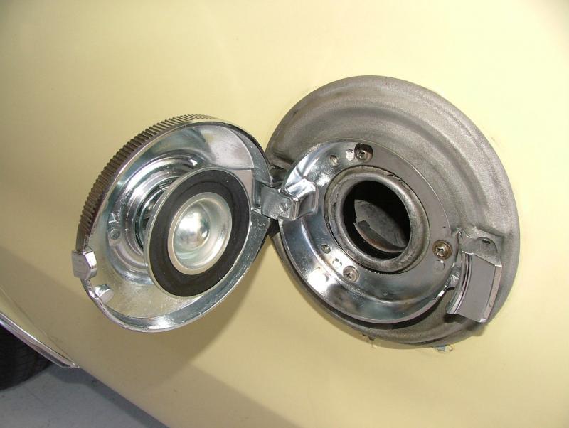

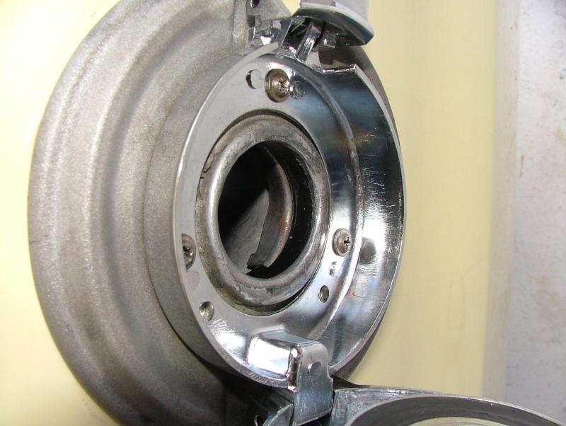

OK, after reading your posts and researching a little more I took a good look at this setup and some pics. I have what I assume to be a repro chrome flip cap with the spring loaded seal on the original trim plate and filler neck, you can see the leak inside the trunk on the undercoating. The sealing surface for the cap on the trim plate looks kind of banged up and worn which could be part of the problem. I can see the rubber seal that goes between the trim plate and the filler neck and that does look like it could be causing the leak inside the trunk. Is that supposed to be caulked with something? My next step is to take it apart and see if it can just be resealed or if I need some new parts.

My 67 GTX has had the same problems. One thing I do to mine that has helped with the fuel leaking past the seal on corners is to put a healthy coating of silicone grease on the seal (dielectric grease). That has stopped any leaking past the seal on my car. I do re-apply a couple times a year. It seems to stand up against fuel reasonably well. If the surface of the fill tube is too beat up you might have to stuff a rag inside it to catch any filings and file or sand the seal surface to smooth it up a little.

I pulled the filler parts off yesterday and have a major leak issue to the point that it has messed up the paint behind the trim plate. There is no sealer of any kind around the rubber gasket so I'm sure that is the problem. I've ordered a plain gas cap from Vans so I can leave the GTX parts off while I fix the paint and I may get a new seal and trim plate. I'm thinking of sealing it all back in place with Permatex Moto-Seal 1 which is supposed be gasoline-proof, has anyone used this stuff and does it work?
Update on this - the gas cap from Van's did not fit so I sent it back. Got sick of messing with this so I took the cap, trim and gasket off again, cleaned everything up and slapped it back together with a generous coating of Permatex Ultra Black RTV. Let it cure and took it out today with a little less than 1/2 tank of gas. No leaks or odor! So far so good...
