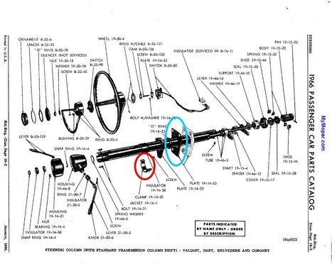

My 67 came with an after market steering wheel and I have bought the original 3 spoke with the inner ring. Of course I'm missing the original mounting hardware and can't seem to figure out how the inner ring attaches to the wheel.
Does anyone know where I can find an illustration of the steering wheel installation?
Thank you,
Bad GTX
http://www.imperialclub.com/Repair/Lit/Master/231/index.htm

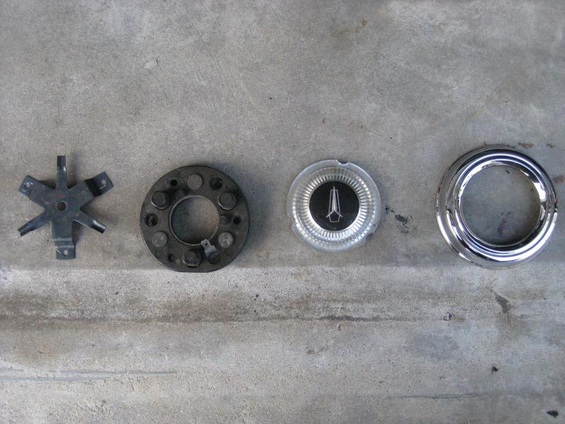

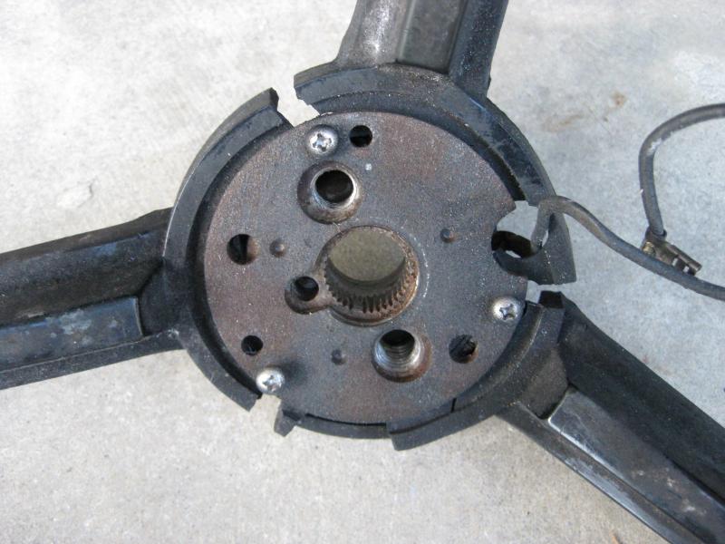

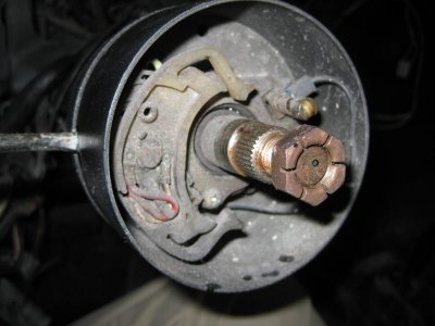

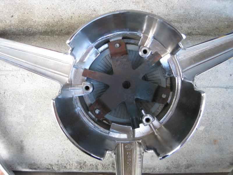

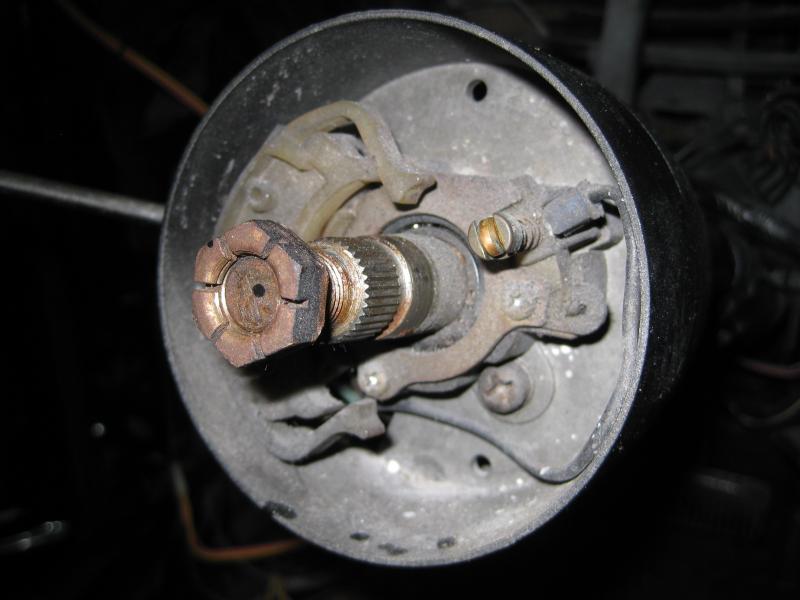

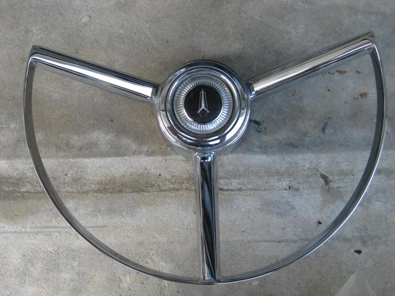

Mine is apart, but this is what it all looks like. Some parts are duplicates.
