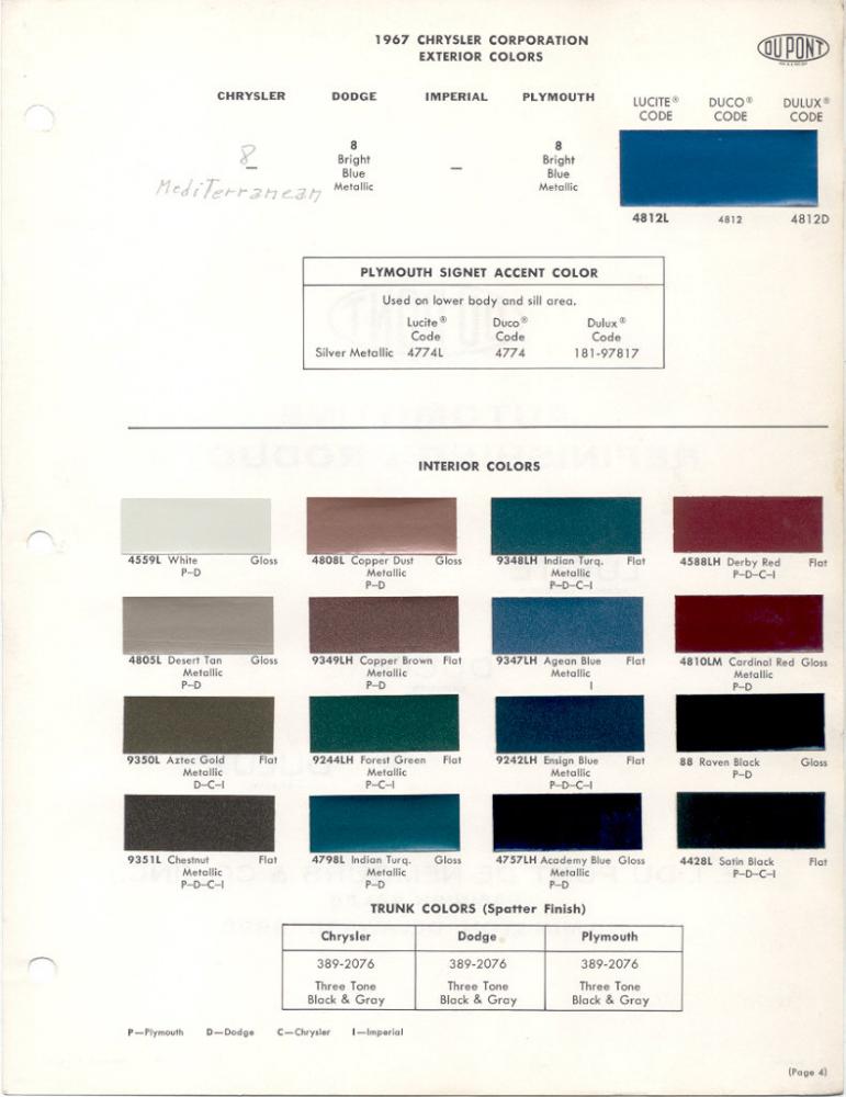

Did any years of Plymouth have spatter finish trunks? My 1970 road runner is body colour too. However I wonder about the paint chip charts that show all available paint options for the year, and under the colour chips is a list of codes for black and argent trim, plus code No. 846 for three tone black and gray trunk finish.
Was this for dealer applications, special factory order, or just a teaser to let you know what you weren't going to be able to get? And if you could get it, would it be on the fender tag?

Here are codes for trunk spatter finish for 1967. My earlier reference was for 1970, so these numbers are different.
Just learned something new about `67 trunk spaces! Thanks Photon440!
That does raise a question or two as to why on the chart. Original color dark metallic green paint was under my speckel paint.
I have never seen spatter paint in any old MoPar trunk and also find the above chart interesting. I wonder if it was something the dealer did. But then I would ask why bother.
