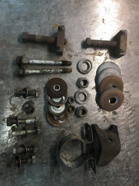

Good morning, im restoring my 67 GTX and trying to do the best that i can, heres my question... im trying to keep all the hardware original as possible. im talking about nuts ,bolts, screws and stuff like that, most of my hardware is rough and in need of re-plating, zinc plating i believe, where can i send these small parts to get re-plated ? can someone recommend a vendor for a small batch of hardware... thank you in advance.. Rich

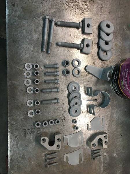

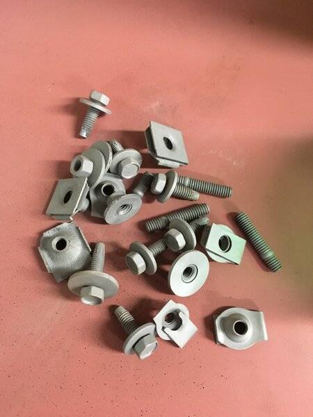

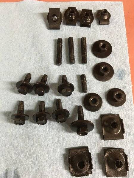

Most of the hardware is phosphate. Anything electrical is typically clear zinc.

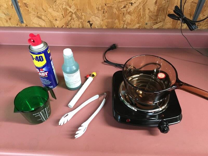

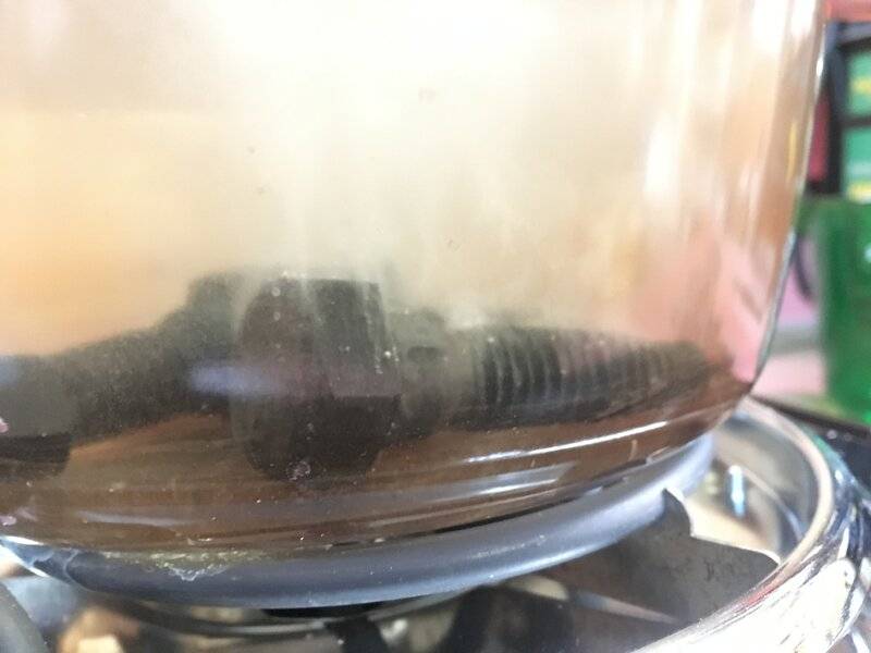

If you can boil water you can do phosphate at home.

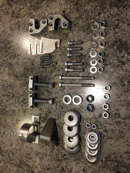

Here was a batch for clear zinc. I have local plater, does a minimum $30 batch.

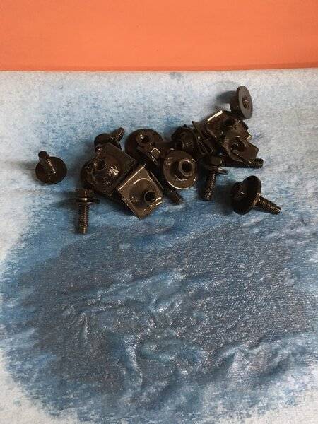

thanks you Moparsaver, i sent them an email...hey 69, looks nice, i did the phosphate kit and it came out nice but now i need the zinc stuff done...
