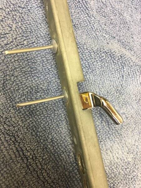

hey all, i will be assembling my vent windows soon and im trying to collect parts for the re-assembly... what kind/size rivets can i use without them interfering with anything and i have the thin washers for the chrome pivot but i need the other washer grommet looking thing , im not sure how to describe it. I think it goes through the hole in the window. where can i buy the rivets... thanks for all your help.. Rich
Are you looking for rivets to hold the pivot arm?
I have no idea what they were specifically. Just measure the hole with a drill bit. Thinking 3/16. Then get the shortest usable rivet you can find. Hardware store stuff. I’m sure I went to my rivet collection and and found something close. I didn’t get rivets on any resto site or anything like that. I’ve done two sets of frames like that now.
im worried that the head will not be flat enough and interfere with something, at least thats what im told, i took them apart awhile ago so my memory on what may or may not interfere is fuzzy
