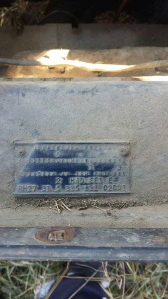

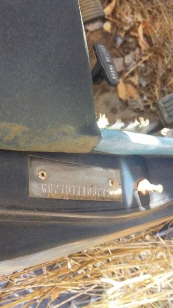

I think the fender tag is not correct for the VIN number on door post Damm :soapbox:
Belv 2dr Convert 273 V8 2bbl 3sp auto
EE1 is Dark Blue
CAR: Plymouth Belvedere 2 Door Convertible
ENGINE: 273cid 2-bbl V8
TRANSMISSION: 3-Speed Automatic
TIRES: Unknown tire code
BUILD DATE: May 31.
AXLE: 2.94 Rear Axle Ratio
INTERIOR: H4B
PAINT: Dark Blue Metallic
Interior 2 tone blue bench seat
E upper door frame paint dark blue
g 0 belt mouldings
Y 3 blue convertible top
R 1 AM radio
335 7.35/14 whitewall tires
2.94 open 8.75 axle
No pinstripe
7753102001 should be stamped on the radiator core support
The serial number will not be on the painted tag posted above.
thanks that's great news I thought the fender tag may be wrong:thumbsup:
