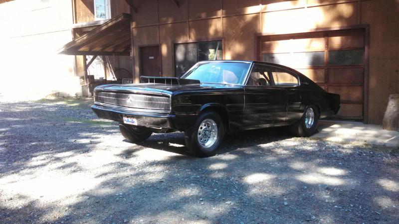

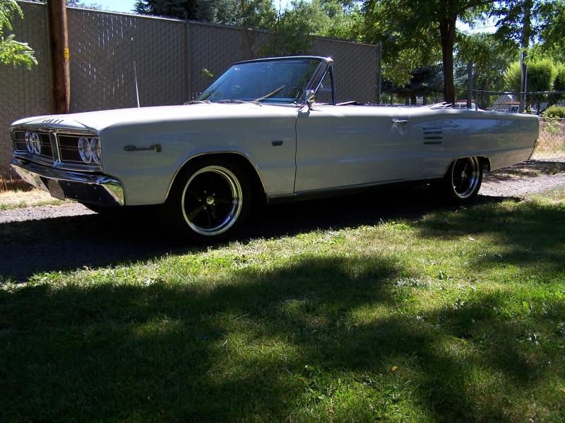

On the suspension I'd be looking at either Hotchkis or Calvert for springs depending on your intended use (cruising, drag racing, cornering, etc.). What wheels and tires are you running? Most likely the front suspension will need to have some components replaced to work with any new parts in the rear. It's amazing how well a thoughtfully designed suspension can change the driving characteristic of a higher horsepower car. All of the above obviously applies to the shocks as well. Here is an example of two cars in our stable that have different intended uses and therefore different suspensions: ResizedImage_1412635735472.jpg100_6326.jpg

Obviously,the Charger is a race car,that I don't need.The Coronet appears to be a Hemi street driver,that is what we need to talk about.I have American Racing Torque Thrust 15 by10 out back.I don't want to re-invent the wheel,just some solid advice on eliminating this very annoying characteristic that is robbing me of FUN!
I forgot to mention that is a beautiful Coronet!
