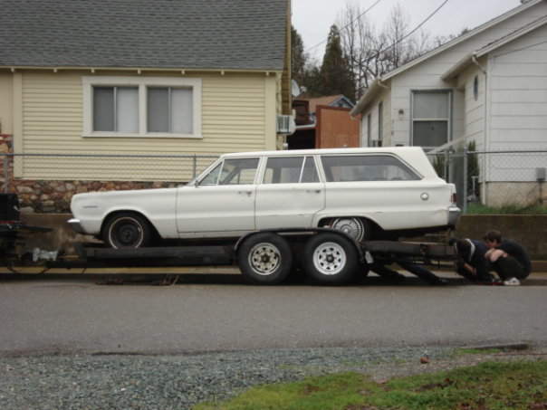

This picture was taken just before I moved her down to the new house. She runs but was not registered at this point and wasn't taking any chances.
