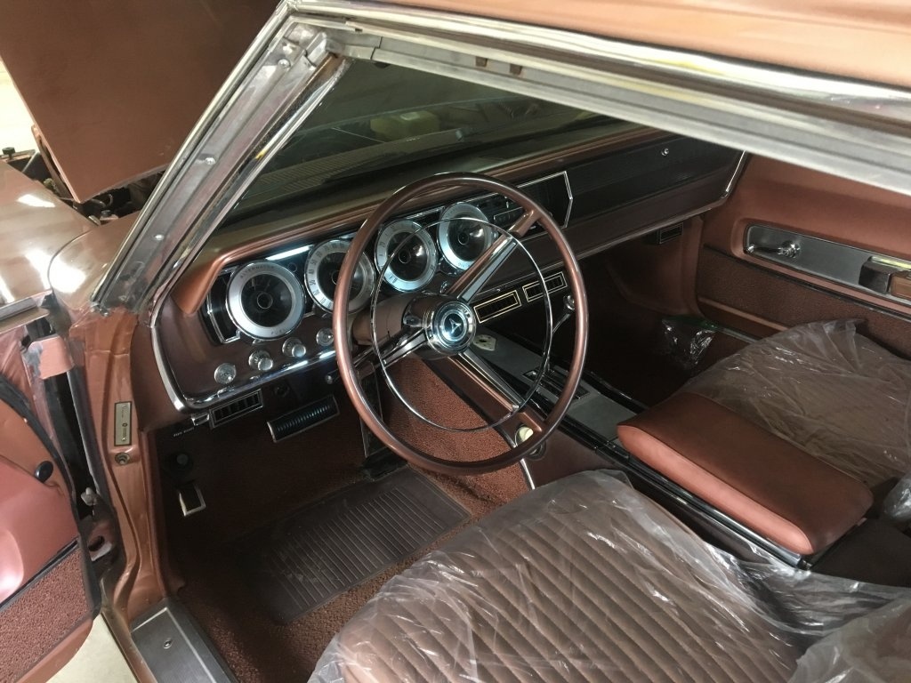

i am having trouble finding the right color for the interior dash and rear arm rest panels. the outside color of the car is tti (medium copper metallic poly). is the front arm rests(metal) the same color as the dash and the rear arm rest panels? my other 67 ht is the same color, but the dash looks dull brown on it. the interior code on the interior fender tag is "t". what color is this?
Copper on copper yummy
Medium Copper with Copper interior. My favorite 67 color combination.
The dash is the same color as the rest of the painted interior it has a flattener mixed in. You could call it matt finish. You wouldn't want gloss, the sun reflection would make it difficult to see.
Look at my dash I used herbs 1171 then used vht hi temp satin clear it worked pretty well.
