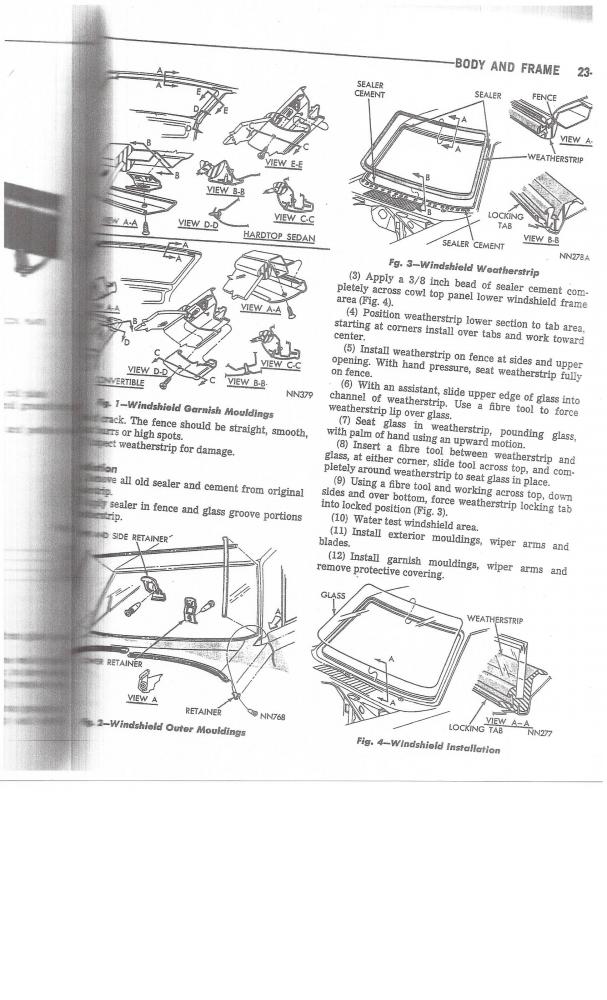

67 Satellite Windshield Install0001.jpg67 Satellite Windshield Install0002.jpgInstructions for 67 Satellite install from the 67 factory shop manual. Sorry for the quality. It is a little too thick for my copier/scanner.
