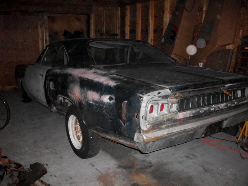

Yes it's a 22. It's a Coronet 500 oringinal 318 car but it's not staying that way. I have a good 68 383 for it and I was wondering if I kept it pretty much stock with the four barrel would it cool okay. Looks gross but besides the trunk the car is in really good shape.
