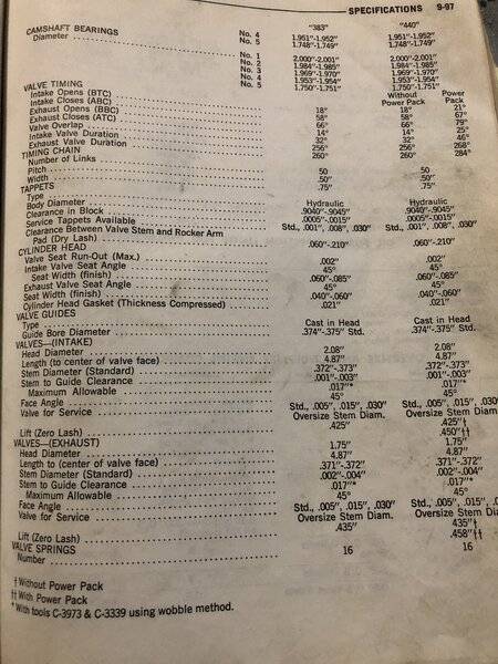

Here are the specs on the '68's. 383-Bee's& roadrunners also had the 440 power pack cam.
