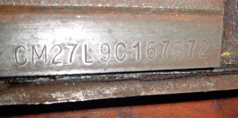

this is what is would look like with the partial vin stamped in it

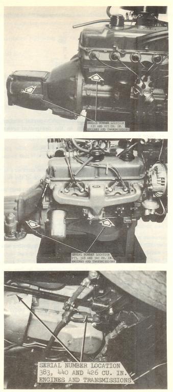

Here is a scan of page 8 of Technical Service Bulletin NO. 69-25-1, August 28 1968 showing the VIN location on the various 1969 engine and transmissions.
A unstamped pad in these locations indicate a warrenty, or replacement engine, which is the next best thing to numbers matching provided the dates fall within the warrenty period.
If anyone is interested I have exact duplicates of the entire 8 page Bulletin titled "1969 Model Identification and starting serial numbers "E" series".

Also included is a shot of a "E" series 440 HP engine with complete VIN.

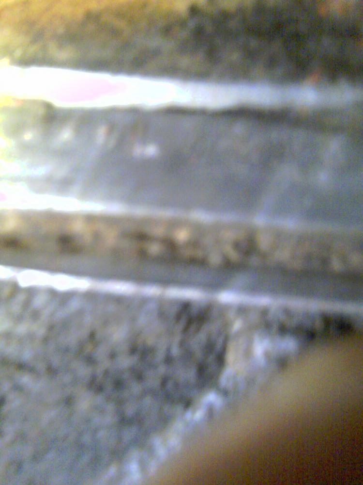

I will check but I even a picture or me re-reading may not get it right the stamping is a little wacked as I said its not straight its almost on a slight diagonal as I recall. The number isnt stamped deep and it doesnt seem to be as large as the ones on the post here and as I said there is like a studder like 333 all within lets say an 1/8 of inch from each other I wouldnt think someone would add this and add it after the fact? But let me see if I can review it one more time I completely cleaned the area though so I may not get 100 percent accuracy on it due to the conditions mentioned above. And has anyone has seen the samp in smaller numbers and misstamping/not in a straight line? Could this have been due to this block being clean being a warranty block and someone adding it later? Ill see if I can get a pic.
So I double checked I can make out the xs29l 3 or B missing the back. L is double stamped BBB. and only about 1/4 of an inch by 1/4 of an inch similar or a little smaller in size to the number on the id pad from the front of the engine looking down at the E440. From the pictures it seems that everyone elses stamps are semi large approx 3/4 to 1 inch or is this just how the pictures show it and everyones are well defined?
It seems any decent sanding of this area the stamp would disappear. (probably good I used mostly degreaser). Can anyone comment on how large their lettering is?
And if its possible someone did this after the fact since its barely indented? Unlike the Engine Pad and the Transmission which is clearly defined? And not miscued?
The lettering barely scratches the surface and there is no indication that anyone has messed with this area it was hidden under 1/4 inch of grease. From what I saw on the other areas Especially the transmission I would have to grind it for a bit to remove it (which I wouldnt do) if I wanted to hide something which doesnt match what I see there at all.
Here is a picture its poor quality but you can almost see nothing there. Which is basically what I am looking at.. Poor quality barely stamped area.
