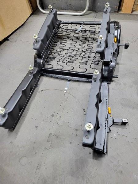

Hello all,
I may be needing bucket seat frames for 68 Dodge Charger. Would like to know if seat frames on all B bodies in 68 and 69 are interchangeable (Charger, Coronet, Road Runner, GTX, etc). Thank you.
Should be the only real difference is the seat covers they vary from model to model and trim package levels. But the seat frames should be the same.
68 and 69 b Body frames and tracks are all the same.... Unless you are looking for six-way on the driver side........ Just be careful if you buy 68 and 9 seats. Make sure they are not a body tracks because those are different... But the seat frames are the same!
The only difference may be headrests or no headrests between the 68 and 69. .
Place in Canada makes them. Think that I got mine through Dantes. Replaced both sides in my '69 Road Runner.
