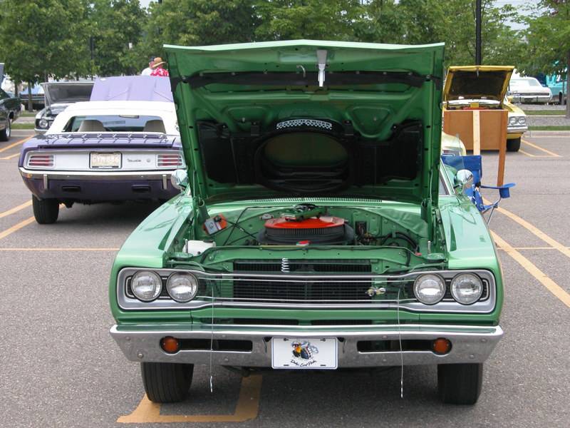

I would think the standard hood stuff would work. Here is a picture I found on the web of the hood catch and latch.

Yes, i'm sure it would. But for which year ? It looks as if the hook for 68 is shorter than 69. And the loop for 68 is longer than for 69. I was hoping someone who has this set up could tell me.

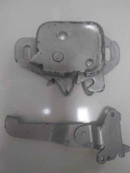

These pieces were in my cars trunk when i bought it. I assume they're for 68. But have no clue if i can use them with the hook & loop that i know i need.
Can’t help Aaron, never have changed my hardware (except when I had a 6-pak hood on). Original latch stayed on as it wasn’t in the way of the glass hood.
