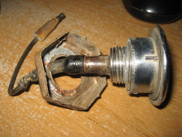

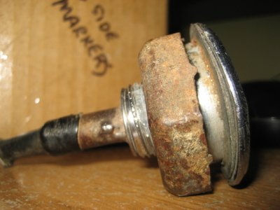

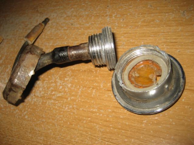

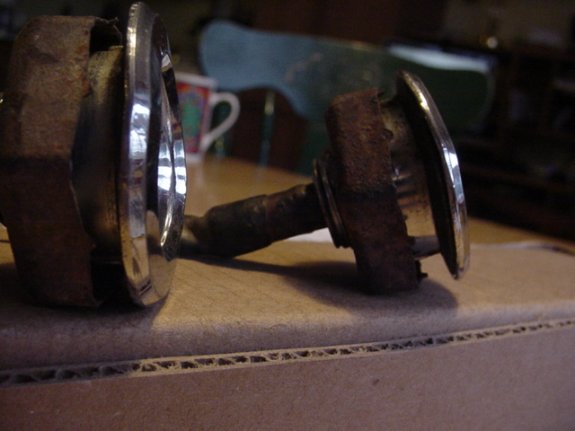

You`ll have to remove the whole assembly. The bulb & or lens are only removable from the inside, but first the light socket inner hex nut must be unscrewed ,then the bulb socket housing must be unscrewed from the outer bezel, that`s right, a lot of unscrewing going on here. Now you can access the bulb or change the lens. This is from a 68 Charger, front, but same idea, I think, from what you have described.

thanks for the very helpful photos 6pktgo!
