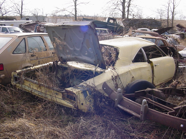

Buckets or Not
Here`s one all original that`s had a rough, ROUGH life & it`s still sits like this today! The owner wants to "Fix it up some day". Post car, bucket seats, 383 4 speed. Probably could have ordered them, back then , any way one wanted to ?
I never stop learning, Who says " Yeh can`t teach this old dog, new tricks!" Thanks "monaco66coupe"
