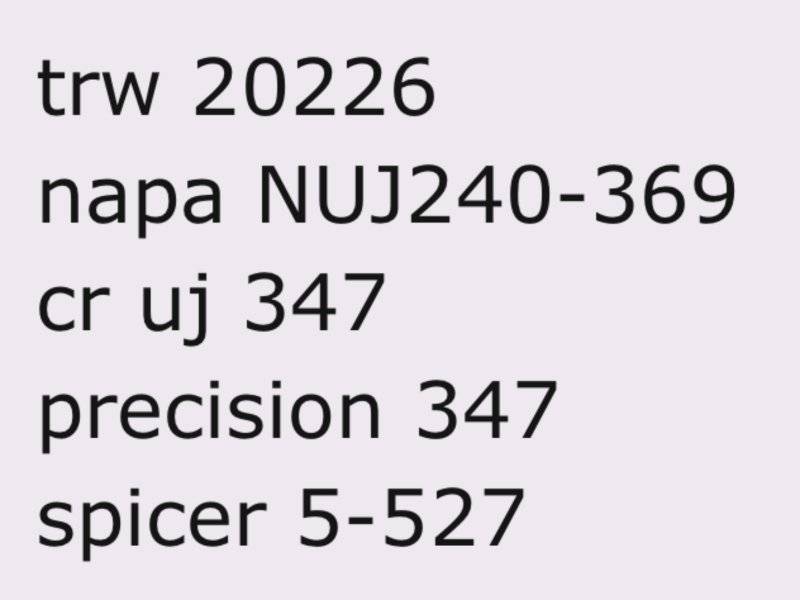

here are some part numbers

It's just like a regular U joint accept one side of the cross is 7260 size & the other side is 7290 size allowing a big yoke drive shaft to run a small yoke axle or the other way around..
