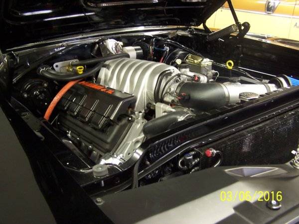

-For my 70 Bee, I went with a retro fit kit from Bouchillion
I found it to be a better system, Sanden compressor, new condenser and parts.
See pics:

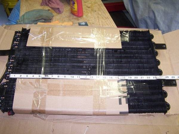

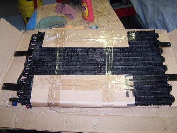

Is this a good enough pic of the condenser? It is the factory piece that was on my 68 Charger. I replaced it with a new aftermarket one that looks identical. I can take a better pic of the original if you need it though. This pic shows the plumbing hook-up locations.
Any chance you could give me the measurements of it? The two I found are not the same size. That should eliminate one.

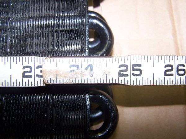

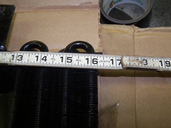

Here are a couple pics. The core measures 16 1/2" X 24 1/8 not including the end coils. This one is the factory one from my 68 Charger.
Thanks for the measurements and good pics!!! I found one just like it but it's kinda rough. At some point a bag of fertilizer spilled by it and some go into the aluminum fins. Turned a section to white powder. Think I can for get that one.
