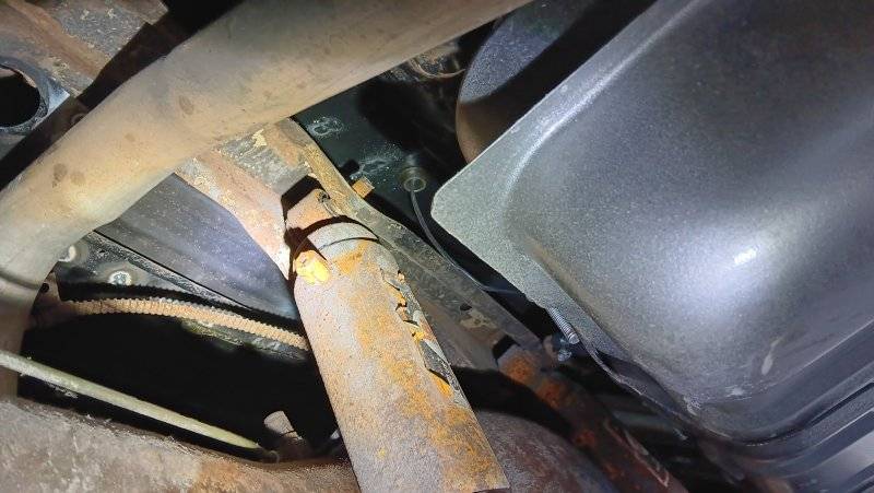

After removing the nut from the upper shock bolt, I assumed it would slide out or maybe need a little persuasion with a pry bar. Nope, it's stuck in there and I've tried unscrewing it, used a crow bar to push on it and now my sawzall blade is bouncing off the bolt. Any suggestions? I can see why nobody ever replaced the rear shocks on this car.

It's funny that someone replaced the hump/trunk floorboard, but didn't replace the shocks. I assume the bolt shank is rusted to the inner sleeve of the shock hoop. Not an area that anyone wants to use a torch or throw a lot of sparks, and there's not a lot of room to swing a "persuader"! You can try the method of spraying the crap out of it with PB Blaster (or preferred equivalent) a few times per day, for a few days, and see if it will free up enough to remove. If that doesn't work, you can split and spread the side of the shock hoop open with an air chisel, remove the shock, then do the same for the inner hoop sleeve that is rusted to the bolt shank.
As a suggestion when you install the new shocks, I've always applied a very light film of anti-seize to the new (or newly wire wheeled) bolt shank-to-shock hoop mating surface.

Yep, looks like they left the shock bracket and shocks in place and welded the trunk floor from above. Probably used the shocks to hold it in place. Love the air chisel idea, I think I can get that in there. Thank you!
Well, if f the tank has never had gas in it, you could try the “acetylene wrench” on the rubber bushing (?). I think the bolt is rusted to the metal insert inside that bushing
Unfortunately, it's full. I may have to remove the tank if I'm gonna use the acetylene option, which I haven't ruled out yet!

Douse it a few times with WD40 or PB Blaster, then give the bolt end a whack with a hammer.
I wish I could get a hammer on it, that's what it needs, but here's not enough room. I'm gonna drop the tank, that may give me enough room to hit with a hammer. If that doesn't work, I'll have the tank out and I'm gonna use the nuclear option (torch it). I'm done.

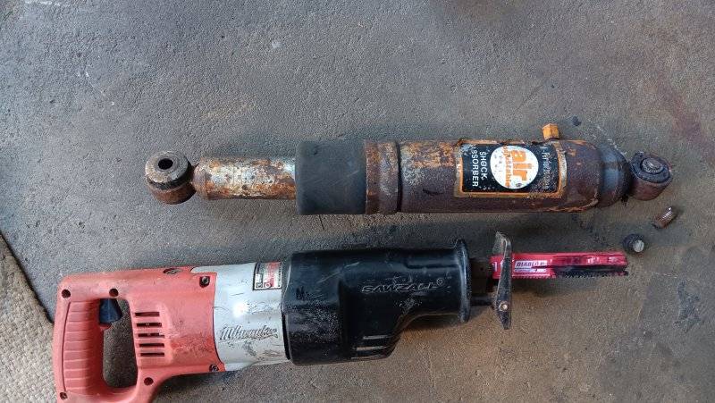

Got it! I found a Diablo Steel Demon blade at the hardware store and was able to cut the bolt on each side. Not sure what grade of bolt the factory put in there, probably grade 5. That's what I'm gonna replace it with. Now, onto the other side! Thank you to all the members for your suggestions and insights. I love 4BBO!20250228_110321.jpg
