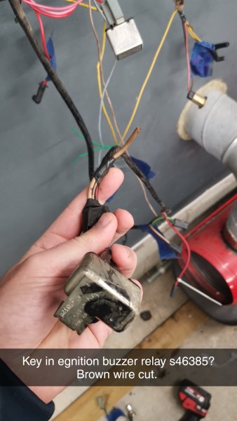

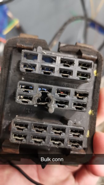

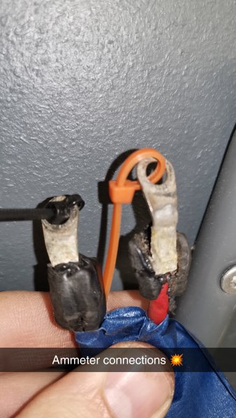

Recently bought my 68 Charger R/T 440 and im planning to spend the winter re-doing as much electrical work as possible
after some findings. Along the road my plan is to upgrade the system to prevent bulkhead connectors seeing to much load.

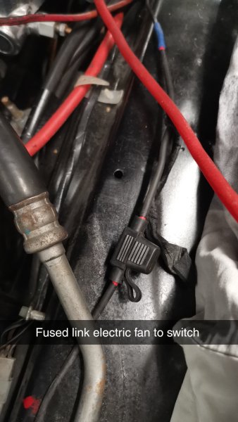

- Troubleshoot electric cooling fan(not cooling when car idling) - wrong type?
I will put all heavy loads connected to the alternator side through a secondary fuse/relay compartment in the engine bay.
This will not affect the ammeter and the car should be safer as well(no heat through bulkhead connections)
