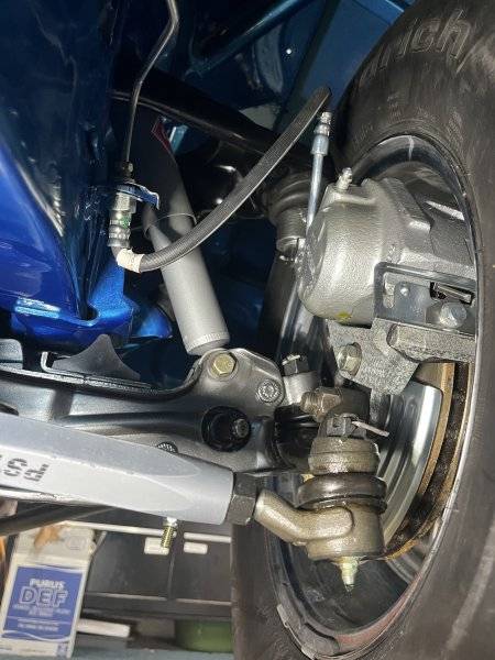

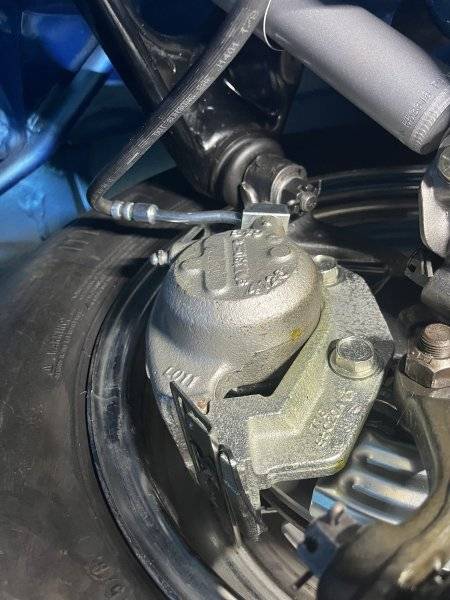

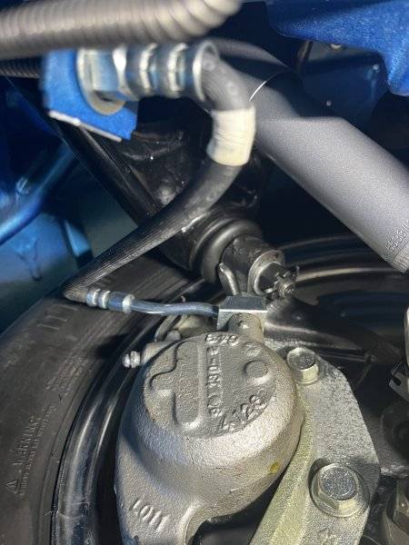

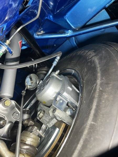

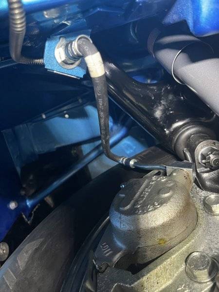

Here are some photos…current hoses have the standard fitting for coupling with hard line, the other end is like a”block fitting”
View attachment 1827833View attachment 1827834View attachment 1827835View attachment 1827836View attachment 1827837
Yah, that’s no good. I’d prefer to have the inlets at the bottom which you could accomplish by swapping the calipers from side to side. Being that the inlet and bleeder would be at the bottom they may be slightly harder to bleed. Some people get around that buy bleeding them not attached to the caliper mount with a block of wood between the pads and the bleeder facing up. Then reattach to the caliper mounts.
When doing these conversions I specify caliper for 85’ diplomat which can accomplish the inlet at the bottom and the bleeder at the top orientation. But yours are still usable just harder to bleed. I don’t care for the one that have the inlet and bleeder so close to each other
Here’s an example of a diplomat spec caliper. You can see the inlet and bleed opposed to each other.
